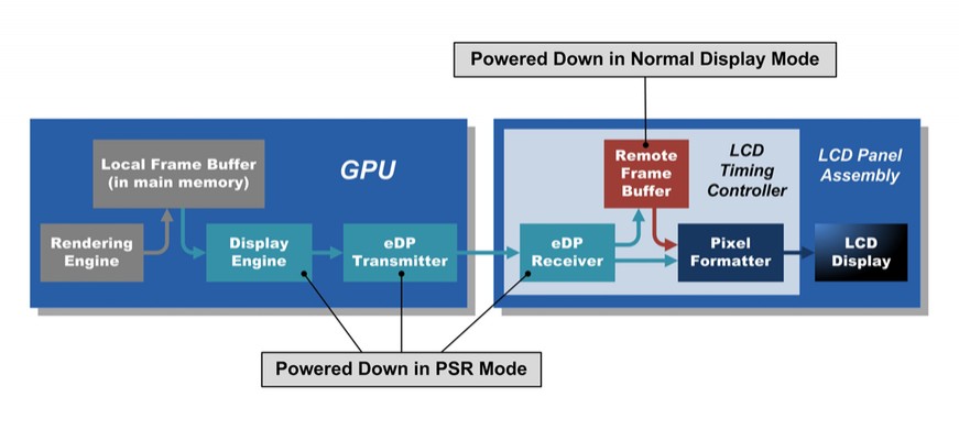

I think the latest findings actually only showed that it's likely Nvidia has the supporting hardware/software combination when directly connected to eDP - the monitor wouldn't require it's own G-sync hardware or direct DPAS support, as it's driven directly by the embedded GPU due to that direct eDP connection. That is, if I understood the breakdown correectly.
If NVIDIA supports it over eDP with no specific G-sync controller, then they would by definition support variable refresh timing over DisplayPort. Which is really all that DPAS is. There's still a Tcon present for eDP, after all.
http://i.cloud.opensystemsmedia.com...6514_paraf0d99c20bd457d46a92c72841873c47.jpeg
I think Nvidia places all of the driving hardware in the monitor, whereas DPAS is really just a minor feature that is, if I understand, directly driven by the card without such a need for middleman hardware.
DPAS requires a bit more middleman hardware than without. You need a better scaler that can handle the variable timing and what to do if the display controller doesn't send a refresh in time.
