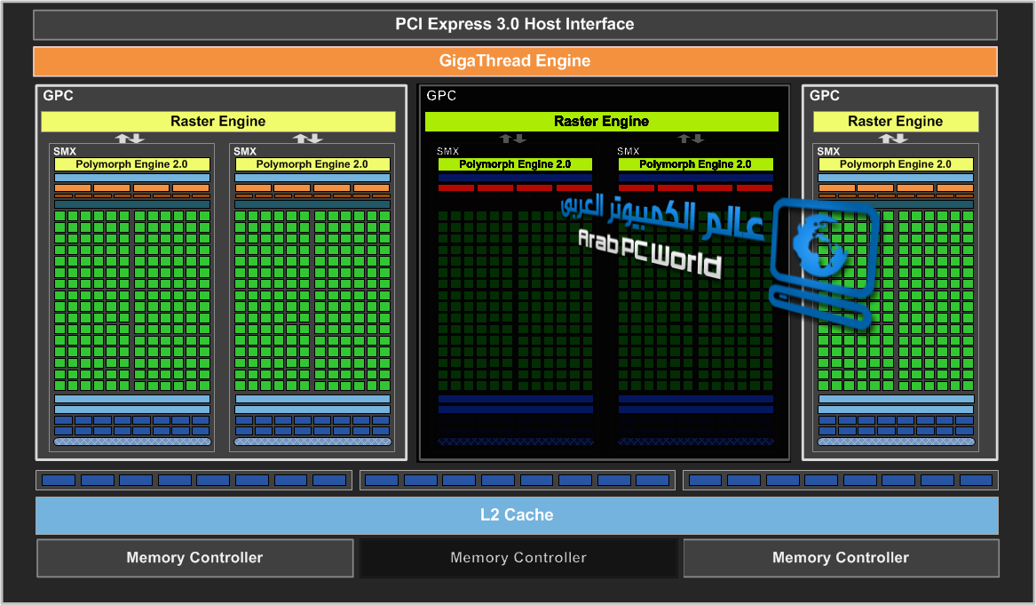

    http://videocardz.com/35234/asus-geforce-gtx-650-ti-lineup-top-oc-detailed
    This card for $150 will get creamed if these specs are right: 48 TMUs, 576 CUDA cores, 86 GB/sec memory bandwidth. This is almost half of a 660.
    "The GTX 650 Ti is based on the GK106 silicon, but with an entire GPC disabled, resulting in a CUDA core count of 576, and TMU count of 48. The memory bus width appears to have been reduced to 128-bit, with a standard memory amount of 1 GB. With a memory clock speed of 1350 MHz (5.40 GHz GDDR5-effective), a memory bandwidth of 86 GB/s is achieved. The GPU is clocked at 960 MHz, there is no GPU Boost feature. With the given configuration, the GPU TDP is expected to be no more than 85W."
    [​IMG]
    Can't see how a card with 85W TDP has any chance against the 7850 or 6950 2GB. Of course it'll be priced lower but even then $150 for an 86GB/sec card is a lot of $ because it basically means noAA.
    I think this card is aimed squarely between HD7770 and HD7850 because AMD has no modern 28nm GPU in the $139-149 range.

    Good news. Looks like the leaked 576 CUDA core specs were wrong.
    TDP goes up from 85 to 110W. There will also be cards with 2GB VRAM option.
