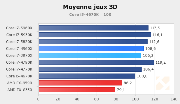

At 5Ghz how would one of these chips compare to an Intel CPU for gaming? Around 2500K levels?
FX8350 is already at 2500K level in games and it will beat it soundly as times goes by, even the 4670K will ultimately be below said FX in gaming.
http://www.hardware.fr/getgraphimg.php?id=25&n=22
http://www.hardware.fr/articles/924-19/indices-performance.html
AMD fans have been repeating the same thing since the 8150 in 2011 (which is newer than the 2500K you are so keen to mention), and we still get 2014 big budget, next gen titles doing stuff like this with AMD VGAs (with Nvidia GPUs it's less bad):
http://pclab.pl/art57916-13.html
4.7GHz worth of 8 core FX to match the 3.4GHz 2500K
http://gamegpu.ru/images/remote/htt...U-Action-Dead_Rising_3-test-dr_3_proz_amd.jpg
5Ghz FX still slower than the 2500K
ouch, overclock the 2500K and the Q1 2011 i5 will achieve a lot more than the "fresh" 8370 for gaming, easily.
8350 at 2500K level is totally inaccurate for the vast majority of games,
Nice to post a single game at PClab.
Btw, next time try to not use deffamation/ad hominem as a mean to denigrate my saying by branding me an "AMD fan".
Hardware.fr updated their game suite, the FX8350 scores increased by 12.5% putting it at barely 10% of the 2500K in games, in applications we wont even discuss this point since this is now a massive win for the FX.
They still have not updated their old charts, that s why i posted their recent reviews using updated games, here the old scores, increase the FX score by 12.5% and do the conclusions you want knowing that this is the average of all their games and not a single game at x resolutions like your "exemple".
http://www.hardware.fr/articles/905-5/performances-jeux-3d.html
Now you can always pretend that games are going the lowly threaded route on the mid term or that the FX is already fully used in said games, in appllications the 8350 was already 25% better, and that s with unupdated softs, you think that it wont show in future games iterations.?..

Even in ABWX's benchmark, an i5 is approximately 15% faster at stock in games than 9590, which is close to 5ghz with turbo. So even if you add 5% more to the 9590 to simulate 5ghz, the stock i5 will be faster. Add in overclocking, and it will be still further ahead.
At real world gaming settings, vs. a 5GHz octocore FX vs. and i5 2500K, I'll take the FX. Overclock the 2500K and things can get closer. But overall, at real world settings, I'd take the FX. BFG made the jump from a 2500K to a 4790K, many here would say that's a sizable jump. It didn't gain much. The FX, especially at 5GHz, is going to be fast enough and I feel it will age better.
Both are still capable CPU's, especially when overclocked. For me, my preference would be the FX, though I can see how someone would be plenty happy with a 2500K too. Both are enough for real world settings in games.
