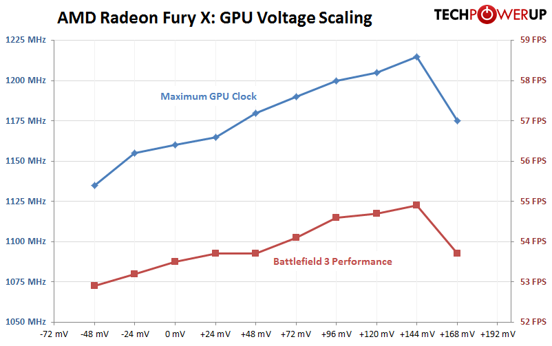

http://www.techpowerup.com/reviews/AMD/R9_Fury_X_Overvoltage/2.html

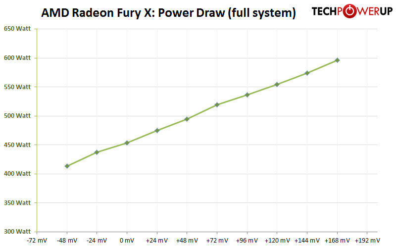

There you go Fury X owners. Go get you some. Article says performance increases linearly at half the percentage of clock rate increases. Max performance/power was about 1220mhz, 10% performance improvement, and power draw increases by nearly 150 watts.
In this graph I'm showing full system power draw during testing. This test has clock speeds fixed at 1100 MHz for better comparison. As you can see, power ramps up very quickly, much faster than maximum clock or performance. From stock to +144 mV, the power draw increases by 27%, while overclocking potential goes up only by 5%, and real-life performance increases by only 3%.
There you go Fury X owners. Go get you some. Article says performance increases linearly at half the percentage of clock rate increases. Max performance/power was about 1220mhz, 10% performance improvement, and power draw increases by nearly 200 watts.
You need to learn how to read the graphs :rolleyes:
Hint: Don't start where the card is undervolted. Start at "0 mv" and don't go any higher then the voltage that gave the highest clocks. +144 mv.

Why does performance goes up with memory OC, its so strange to think Fiji would be bandwidth starved? Smells like a latency issue at play.
Here:
Basically core OC alone doesn't seem to scale well but with memory OC added it scales good. Odd behavior, wonder if Fiji or BF3.
For reference, 4K BF3 results:
Edit: So very strange to think a GPU with that much bandwidth is BOTTLENECKED by memory performance. o_O

I much prefer the undervolt results.
-48mV Vcore and still running "OC" speeds at over 1,125mhz from stock 1050mhz speed. With a 50W power savings.
With a slight vram bump, should get 5% above stock Fury X performance while saving a lot of power. Win-win. :) I did the same with my R290s. Sipping power with an undervolt, ~160W gaming load is amazing for R290 class performance (similar to 970!).
You're right, but I was paraphrasing the article. Looks like wizard did a ninja edit, because at the end where he says "Looking at the numbers, I'm not sure if a 150W power draw increase, just to get an extra 3 FPS, is worth it for most gamers," it did say 200W.

Wow, what terrible overclocking potential. +144mV for a measly 60MHz? My 290s can hit a 150MHz overclock with +50mV, and 980 can do even more with almost no voltage increase. WTF were they smoking when they said this was an overclockers dream? :rolleyes:

Holy crap! 150 watts for 3fps gain? Would the gains be better/bigger in other games?

Does this indicate there is some kind of bottleneck that can't really be avoided with overclocking? Maybe something to do with the use of an interposer?

It does seem like there is some sort unintuitive bottleneck that so far is unidentified.
Maybe these cards will be VR monsters and AMD has some extra junk in the trunk that only VR can use...
I don't think Fury is bandwidth starved (since BF3 probably doesn't have that huge a Frame Buffer or models\textures requirement even at 4k), but maybe increasing memory speed (since it's a slow wide bus) helps decrease access times. As Huddy pointed out in the TechTeamGB interview where the extra bandwidth helps is in large model/texture games where textures and models can be streamed from system memory while not affecting memory bandwidth related to framebuffer\rendering. Actually, that's his reasoning that 4GB HBM can be effectively as fast as 6 or 12GB of memory so maybe BS.

The interposer is just a method of attaching it to the board. This is more an issue with the GPU's internals and their ability to clock. The board's VRM should be more than enough to handle the electrical requirements; the cooling is "sufficient" (at the very least better than typical air cooling); and the voltage can now be turned up.
I'm quite surprised that HBM overclocking has any effect at all. What the hell is it doing with all of that bandwidth? Though, as mentioned above, could it be a latency problem?
