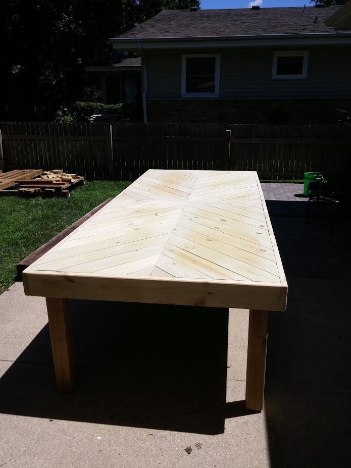

I do like to play with wood...
uJ0_42en5CO9uqdEJi8yp6KrMw6xkj7QsV5daPDlkTs=w1236-h927-no
_GNpdr9lJsdPZmflmDESXoAE0vvQSjmChB54jFuEWAs=w696-h927-no

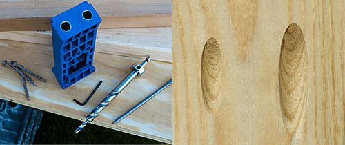

When you want to "cheat" a little, pocket screws are a god-send. So along with the aforementioned tools, I highly recommend a collection of Kreg kigs/drills/screws
