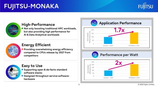

Successor to Fujitsu's custom supercomputer ARM CPU A64FX named as Monaka, with ARMv9, SVE2 and 150 cores scheduled for 2026/27 release, apparently targetted at datacenters rather than supercomputer use cases.
Width of the SVE2 units is not declared, but it will be built on TSMC's N2 node.

Fujitsu A64FX was mainly built and sold for the Fugaku supercomputer, so my only guess is that a supercomputer project of comparable size doesn't exist (yet?) for Monaka so Fujitsu looks to sell more of it through regular channels.
A bit unfortunate. Fugaku/A64FX achieved what Intel never could with Larrabee and its successors. The simplicity of the programming model for Fugaku vs. other supercomputers alone should have made such a successor appealing to data scientists.
