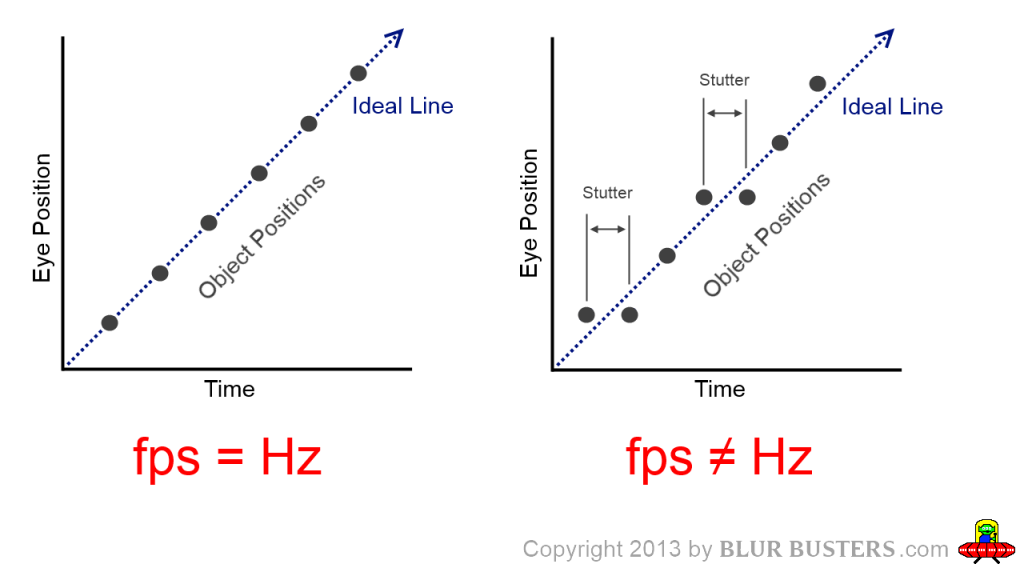

Mark Rejhon
Dec 13, 2012
273
Some additional very interesting factors for measuring fluidity.
This is a visually separate subject than input lag (though is partially linked, since a higher framerate can have lower input lag, as seen in AnandTech's testing and input lag graph).
(1) Microstutters. Consistent frametimes with 80fps looks smoother than random frametimes at 120fps. Basically, you see less stutters/judder/jerkiness if the frames are delivered to your eyes on a more regular fashion. Even if it involvs partial frames (e.g. slices of frames during VSYNC OFF)
(2) Your computer mouse can be the limiting performance in smoothness. A highly acclaimed 1000Hz mouse, can look smoother at the same framerate than a cheap mouse. If you cannot slowly turn left/right with your mouse as fluidly as you can keyboard strafe left/right, then your mouse is definitely the limiting factor in motion fluidity. Adjust game sensitivity a bit lower, and hardware sensitivity a bit higher, can help too.
(3) Displays with less motion blur, makes it easier to see stutters. For example, CRT, plasma, and LightBoost displays is easier to see tearing and stutters (e.g. even one framedrop at 119fps@120Hz) than on regular LCD displays.
(4) Synchronization with refresh can improve motion fluidity (note: separate topic than input lag).
e.g. 120fps@120Hz VSYNC ON can still look smoother than 300fps@120Hz VSYNC OFF. Unfortunately, VSYNC ON adds input lag, so a good compromise setting is Adaptive VSYNC, which is like an input-lag-reduced VSYNC ON. (You simply get tearing instead of sudden slowdowns, everytime you drop below framerate=Hz).
