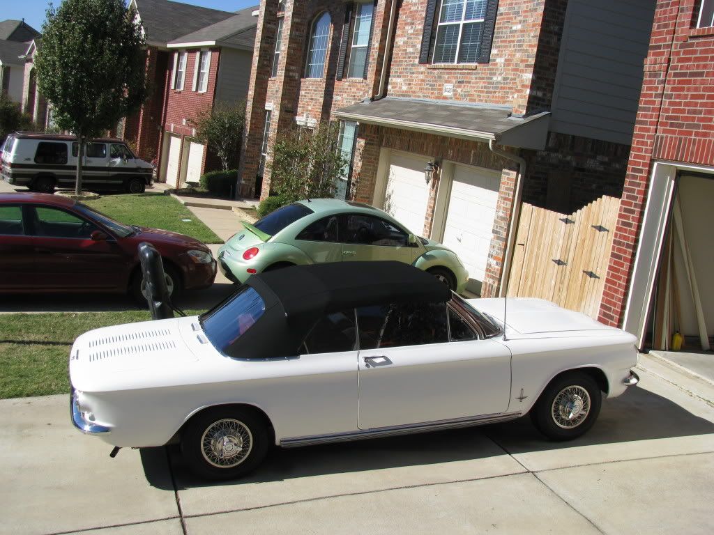

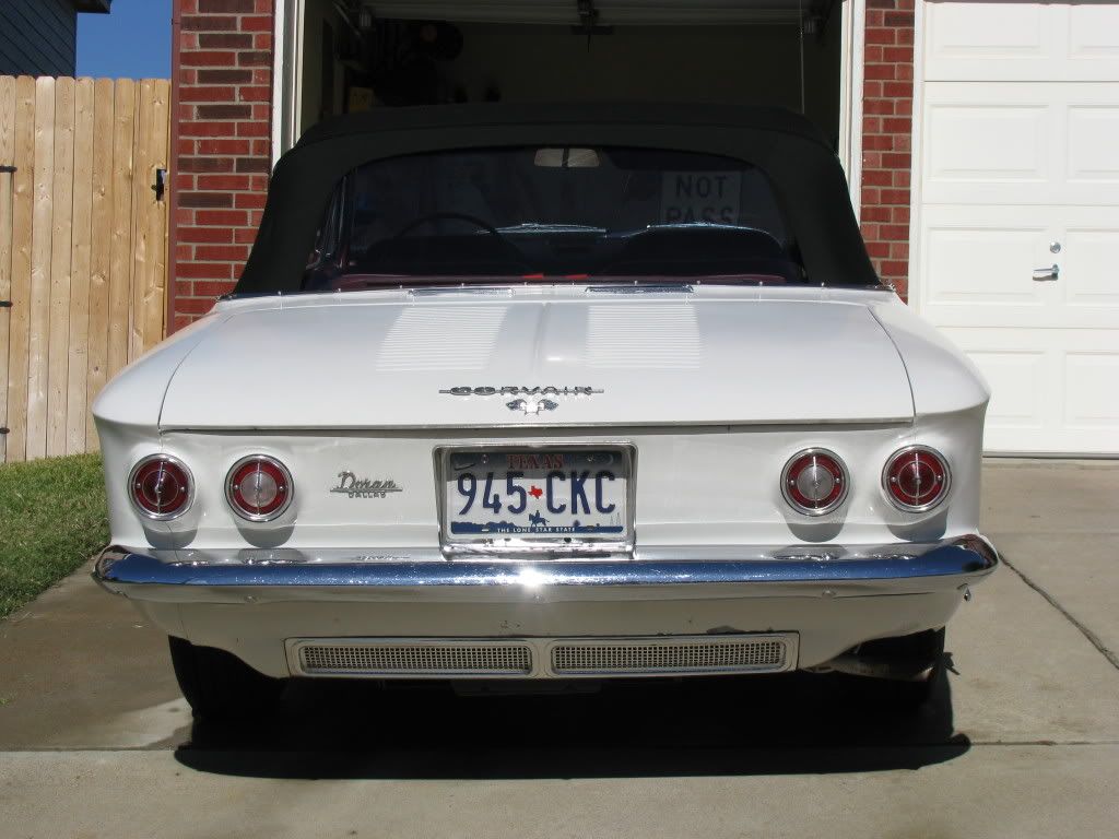

Post some pictures of your car. How much time did it take you to take the head off? I am looking into getting a used Subaru and am wondering what is involved in their maintenance.

Front view:
Rear view:
Side view:
It took about 30 minutes to get the head off, simply from the fact that I had to remove all the engine air-cooling shrouds.

That's no Subaru! ;)

My Aunt had a light blue Corvair Monza. I have always loved Corvairs.
The Science Patrol drove them, too.

Nice corvair! If you're in/near san antonio you may know my father via the local corvair club. He absolutely loves his.
