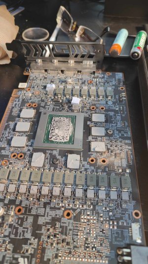

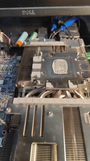

And really didnt like what I saw when I removed the heatsink :O

HUH its a no wonder the Hotspot and gpu temps were higher than I liked them to be, glad I checked.

year and a half, if that, its a Powercolor Red Devil 6900xt, that was the stock paste, or lack thereof :O

What environment is that PC / card kept in to look like a decade old card in just 18 months? I have a feeling this isn't specifically an AMD issue...

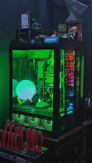

It lives in this monstrosity of a case with a ton of fans....and are you suggesting that where it is at caused it to have no paste on the core from the factory for the paste was NOT dried up on it??? Airflow is out of the question here, for it idles at 47, and now 85 under load.

Check to make sure that the back side of the case is getting enough cool airflow on the intake fans for the GPU. Even though you have a reasonable amount of airflow - the directionality could be causing you problems.

I have it set up so the case has positive pressure so that air can escape from the rear vents holes as well. My 200mm fans are on the very top of the case to draw out any hot air collecting on the top inside of the case, and the front 120mm's actually dump into the back of the case, while I have the 200mm ones on the top in the front, so it draws it in, takes it to the rear, and the top fans suck it out the rear, and out the top front. There is also some vents on the top rear of the case as well, so it get bodacious air flow, and keeps it super cold in there for Im getting 45c on the cpu and NOT using a noctua heatsink. Cpu is a non overclocked 5600X if anyone cases to know. So ANY hot air collected in the front of the case is expelled right away keeping it all chilly.
The case is HUGE in the rear for you can stick in 8 5 1/4 hard drives back there, and another two on the bottom, I just LOVE my case, and was lucky enough to get it off Amazon on a super sale for like $100
HIGHLY recommend the case I use, if you have the room for something this big.

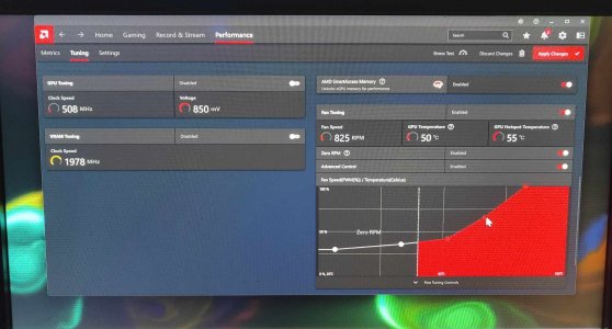

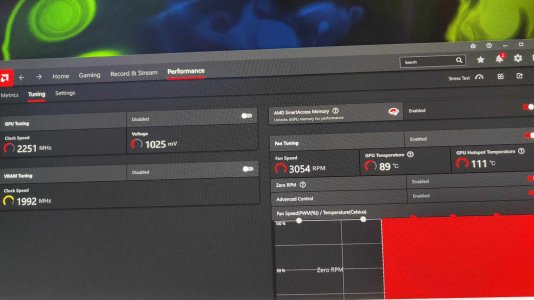

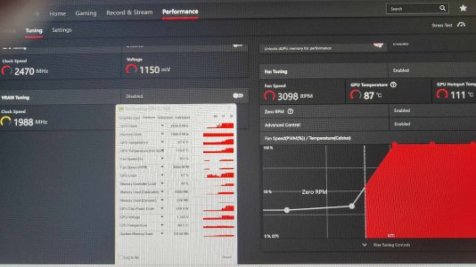

So yes, this is driving me insane for I would think that at full tilt it would make a tickle in the temps, but it doesn't faze it one bit, and below is a picture at idle no fan on at all, and then here it is just playing GRiD 2019 at just 1080P (setting maxed out).....keep in mind that with GRiD its strictly at the press 'a' screen, NO game graphics is being played at all, and yet that's its temps, with the fans going full tilt. ALL its pads are fine, even though I put to thin a layer of paste the first time go , it was evenly spread, so I am setting the card down right and not tilted in anyway leaving some of the die uncovered, but yes, at fans full tilt I would think it would make the temps budge, but set to standard, or me manually setting the fan curve, the temps all stay the same with out a change. Its as though even if set to max, it doesn't make a difference, and for giggles again, set fans to max at idle, it not mattering at all their either, so Im thinking faulty sensors. The games, and time spy don't seem to matter where the clocks at, and me thinks I have faulty sensors like mentioned perhaps. If reading it right, its also seeming to go way past its boosted speed (see last pic) and voltage its at 1200 :O
I am WAY open to suggestions, for I just don't get it, and even at them temps the games play just fine as if it is nothing, setting the fans from 60% max to 100% max, and leaving the fan curve alone, it ramps the fans to 60% still, yet the temps do not change, nor does the speed, so its not throttling down, and then set fans to full tilt 100%, its screaming in my case and yet again, speed stays the same, along with all the temps, I don't know what else to do. Pinball, and now GRiD 2019 making my card go nuts, and blazing hot, and that's with GRiD again just at the press 'a' greeting screen, and nothing else.
410270299_729290629134818_3731117923587193632_n.jpg414599296_928295585308423_1077561264288140428_n.jpg
Not Overclocking a single thing, and bios set to normal, if this matters.

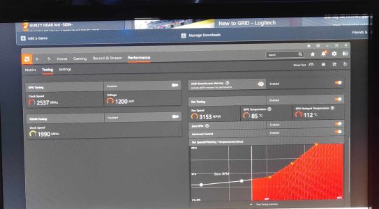

Heck here is GRiD 2, and 10 year old game, about to be 11, and wowzers mid/high 80s on the outer die, and dying on the hot spot. Graphics set to 4K maxed out, but didnt matter 4k or 1440P some results. Shmee I too would think with a huge honking 3 slot cooler this should be a ice cube, but far from it. Googling 6900xt also shows that Im not the only one, and that its stated the 6900 xt runs hot, at 300+ watts being drawn, where may card at maxed graphics n all maybe will pull 250 watts. OH and my power supply is a 1100 watt Corsair, about a year old. Automatic undervolt, drops it too 1176, and is stable, but I cannot find a happy place myself, unless Im doing something wrong, but I watched several videos on how to do it, and read some articles as well, just no matter what I do, if I do anything other than auto undervolt it will crash the driver.

What drivers are you using? Latest 23.12.1? Though if I am reading correctly that fanspeed isn't making a difference, whether on auto or manual 100%, I suspect either the temperatures aren't reading correctly in drivers, or your cooler is not properly seated, perhaps you need to tighten it more?
An easy test would be to try monitoring temperatures by another program, such as GPUz or HWinfo64.
funboy6942
Nov 13, 2001
15,368
418
Latest drivers, fan speed doesn't matter, the card is seated properly, with adequate paste, way better than stock, and going to install gpu z right now, though the AMD driver is picking up its running at 110-112c and maxing out the fans.

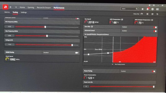

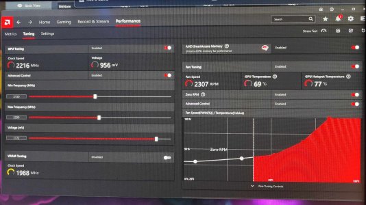

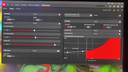

Well I think I found me a stable undervoltage setting, and made a seriously HUGE difference in GRiD 2019, but on the flip side made Time Spy even worse with it flicking between 108-113c! I had such high hopes after seeing what I got GRiD to do to be disapointed with Time Spy. On the uptick thoguh, it was stable and ran through the test. Going to try Pinball FX now and raise it to 1440P again to see whats what with it now.
GRiD
Time Spy:
