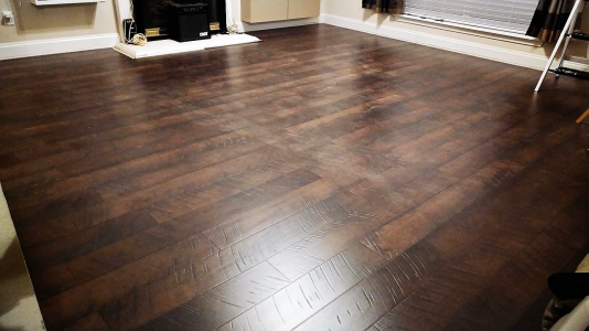

I would recommend replacing your carpet with anything but carpet and then using a large area rug or something. The amount of dust, dander and god knows what else that will get stuck in your carpet/carpet pad is insane and no amount of vaccuuming will really get it.
I have replaced all of the carpet (myself) in my home with mostly laminate (been very happy with the pergo duralast stuff) and some traffic master vinyl stuff. I tried some of the cheaper end flooring and definitely recommend avoiding that.

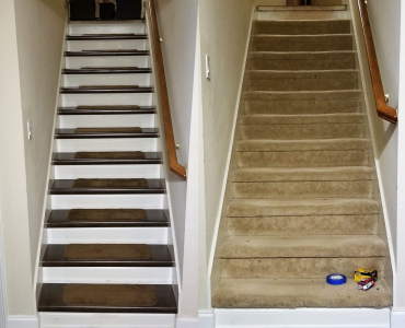

You would not believe how bad it was pulling up the carpet and the pad. To top it off, there were so much debris behind the baseboards since I replaced them with taller ones (I bought the house new back in 2003 and replaced the carpet about 6 years ago)...more junk, nails, screws/dry wall scraps, dirt, etc....
The 'funnest' part was replacing all of the carpet on the stairs....definitely saved that project for last bit...
Living room with the pergo laminate:
Before/After pic of the stairs (put the carpet pads on the stair treads for my puppy):

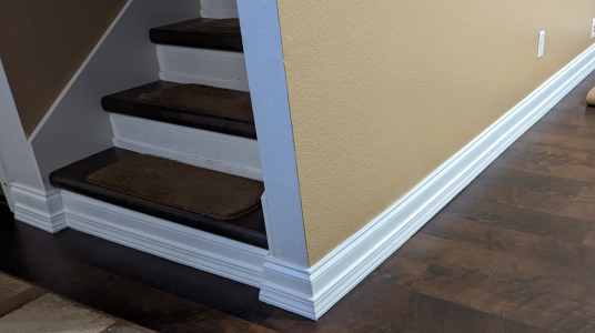

Instead of the standard quarterround option, I went with this look to cover my gap...I was pretty happy with the result...
Not terrible .... but the "edge" is still pretty obvious. (sorry) Another plus to removing/replacing the baseboards is that you don't NEED the divide to look "perfect".
It should last but I wouldn't be happy unless it was my first try .... in which case not bad! ;)
No worries...I am still happy with it and knowing I didn't have it put with half-assed contractors trying to short cut everything made it even more worthwhile...
Not sure what you're looking at, but it looks like his cuts are all under the trim. Great job spacejams.
