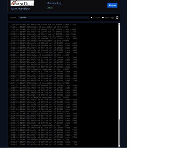

Two machines in the same location, same wifi connection. One machine performing like clockwork, but the other has not uploaded a completed WU in three hours. I literally watched it go through the process of uploading, but there is no record of them in the logs. Downloading/starting as normal after the supposed upload. Two gpu's on the machine and neither showing/recording uploads. Any ideas?

Anything if you check Errors and Warnings in upper right?
No errors. I think I just figured it out...they are actually uploading, but the completion time has become painfully slow on this particular machine. The records are far below in the logs with so many machines running atm. I'm timing one WU right now to get a idea just how long it really is taking to complete.

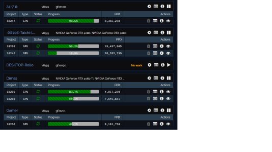

Here is the Dimas machine with a 3080 at 50% completion...48 minutes to get this far. I've never actually timed any of these before, but that seems mighty slow to me. I'll post the total completion time in a bit. Heck, my AMD cards (7900XT, 9070XT) are kicking the 3080's butt lol.

Edit: It took the 3080 90 minutes total to complete the 18260 WU.

Apologies for the false alarm. I still don't know if the gpus/machine is performing sub par, but I now have a good idea how much time it takes to complete a WU. I checked every gpu on every machine I have to get completion times...it was like watching paint dry lol. :sweatsmile:

PCIe lane bandwidth effects F@H I believe.
Running stuff on the CPU also effects the GPU projects.
I would look there to see if their is some kind of bottle neck from CPU use or PCIe bandwidth issues.
Also, check to make sure the card is not throttling or stuck in a lower power state.

There is nothing other than FAH running on that machine and I see no problems with either gpu...other than being slow lol. This may well be normal and I have just not noticed it before now. That machine is the only AM4 rig...the rest are AM5. I have debated on making the switch to AM5 on that rig as I already have all the components on hand minus a motherboard. The Taichi Lite just so happens to be on sale right now... ;) That is the mb underneath the 4080's currently.
What was more shocking is the amount of time it took the 9070 XT to complete a WU...2 hours and 1 minute. :eek: The 7900 XT gets the job done in 60 minutes.
