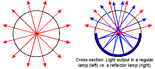

I want this bulb:http://en.wikipedia.org/wiki/Fluorescent_lighting#Reflectors
It's in the description yet I can't find it for sale. What I really want to do is change the lighting in my room with T5 sized bulbs that will run across the middle of the room. Problem is, most fixtures and bulbs direct the light in all directions which is extremely wasteful and so I want a bulb that will direct the light in the direction I want.
I had the idea of just taking a regular fluorescent bulb and spraying some chrome paint on it but I'm a little concerned about electrical hazard of doing that.

See it...? When you mount a fluorescent bulb into a fixture, half of the light is going back into the fixture itself which is very wasteful. I don't commonly see lighting fixtures with reflectors on them despite them benefiting from them but one application where this is common is in hydroponics. In hydroponics, they attempt to utilize as much of the useful light as possible, unlike in current interior lighting.

Lets say I need 8, 4ft Fluorescent bulbs. That means a pair of light bulbs every 4 feet. Now, if I can direct half of the light that is being directed in a useless direction to a useful direction, then I'll be able to cut the number of bulbs I use in half. Remember, the light in these bulbs normally goes equally in all directions, so if I can reflect the light that goes in a "useless" direction into a useful direction, then there is a strong possibility of me being able to have the same amount of light output despite using half the number of bulbs.
In configurations where it's a pair of bulbs, you not only have light being wasted illuminating the fixture but also a fraction of the light going into the neighboring bulb.
So, to save space, increase simplicity (a reflector plus half the bulbs is indeed simpler), save electricity and henceforth save money on electricity and bulb purchases, I feel it would be prudent of me to purchase a high quality reflector for these bulbs.. There is a reason why automotive headlights, flash lights, CFL FLOOD lights, etc. use a reflector... to redirect the light in a useful direction.

Most fixtures have built in reflectors. White painted metal is an extremely effective reflector.
It may not be as specular as a mirror finish, but it is just as reflective.
White surfaces diffuse the reflected light, so it is not as apparent as a mirror finish.
As long as you have a white surface above your bulb, you are not wasting much light.
Each bounce off of a flat white surface loses about ~10-20% through absorption.

Most people lose more only because they never bother to clean them. Also 'mirror' or 'silver' tends to aim the light more (spot light affect) and may actually reduce ambient light level in a room except right under the fixture. Adding a reflector right to the bulb will direct most of the light down in a narrow arc rather than disbursing it around the room. More fixtures would likely be needed to get the room to 'feel as bright.'
This is the same reason LED lights at the same lumen level often feel dimmer. They spot rather than throw light.
