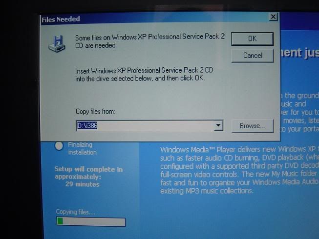

UPDATE: FIXED!!
Finally got a break from midterms to get back to work on this. Got my hands on another cd-rom drive and this one didn't lock up during instalation so it went smoothly (There was also a little bit of BIOS tweaking but don't know if that fixed it). Thank you all so much for all your help. :beer: :beer: :beer: to all.

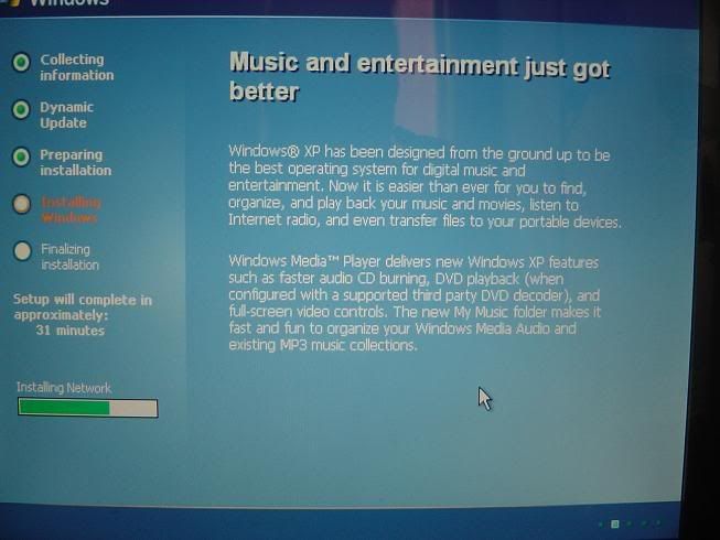

I tried to re-install XP and during instalation everything was going ok but then it said it needed some files from the D: drive, so I browse and try to select it but it has a red question mark beside the D: icon and it says it does not exist, I try to open and close the cd rom tray and nothing happens, it won't open or respond at all and yet it was just working fine during the rest of the instalation. So I just press cancel and have to press cancel twice for 2 different things.

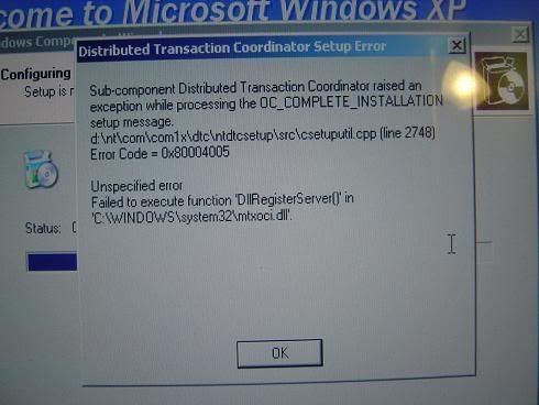

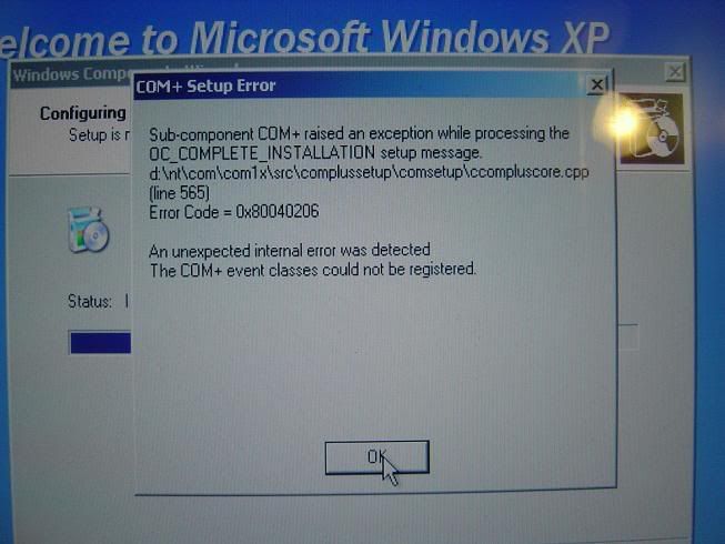

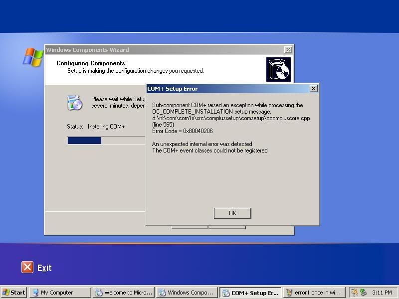

Windows finishes installing but I am missing a bunch of stuff, like it only has the classic skin and I can't seem to set up my internet. I open the cd and go to add files from the cd like explorer and networking etc... but I get 2 error messages (which I have pictures of but can't upload.
