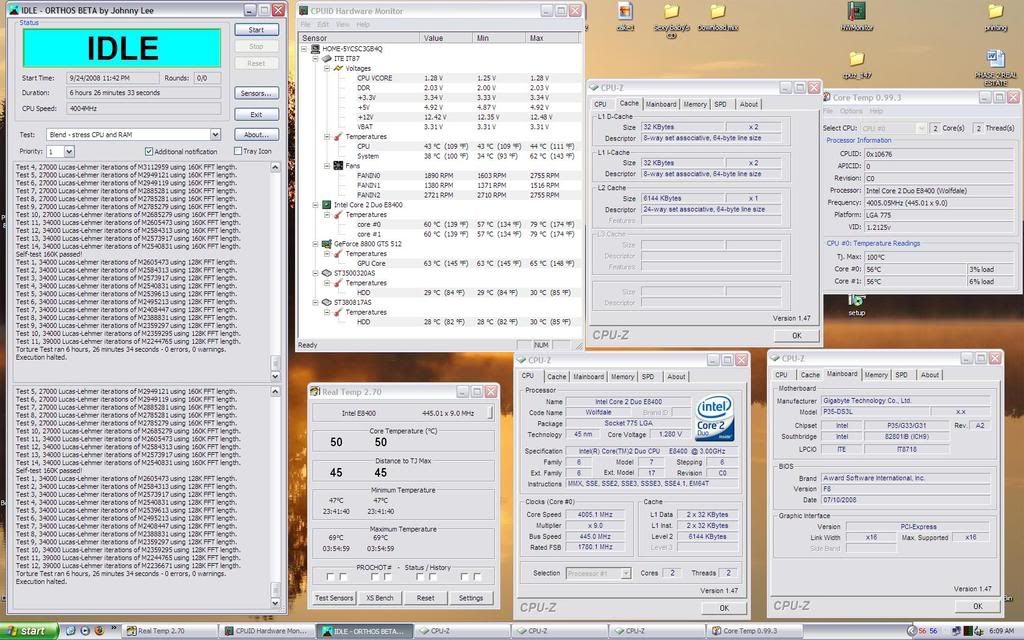

Update 1:
I tried the program called Core Temp and its showing the Core0, 1 temps 5C LOWER than HW Monitor is showing
Which program should i trust ?
(after a few steady minutes in Orthos its showing me 65-67C MAX and a VID of 1.2125 while HW Monitor is reporting 70-72C) i also lowered the voltage in BIOS to 1.275 and CPUZ is showing 1.216 - 1.232 so far everything is stable as i type this

Open Coretemp, Realtemp, Orthos, and Cpu-Z simultaneously. Open cpu-z 4 times and display each tab of information. Start Orthos & after about 5-10 minutes take a screenshot. Post that screenie up here, and we can help you.
You want a delta to tjmax > 25C, IMO, you want stability, and actual vcore of < 1.400v

^ yeah i have realtemp 2.70 and it makes the numbers i like LOL
no it has the most reasonable ( and lowest ) values, strangely coretemp is exactly 5C higher than Realtemp and HW monitor is exactly 5C higher than coretemp, so its really weird

you might want to use the latest versions: Real Temp 2.75 and Core Temp 0.99.3

Nice. 4.0Ghz @ 1.248v Load for a C0 stepping is not bad. You either have 31C or 29C Distance to Tjmax. I wouldn't let this number get smaller than 24-25C. This is only about 4 to 6C degrees of play until your at max temperatures. You still have about 0.15 volts of play until you reach 1.400v. Overall great O/C! If you want more than 4000mhz it will take more vcore, but keep the temps reasonable, or look for something better than your AC F7P.
I can't see the speed of your Ram, could you show the Memory/ SPD tabs instead of the Cache tab? HM shows 2.0 Vdimm.

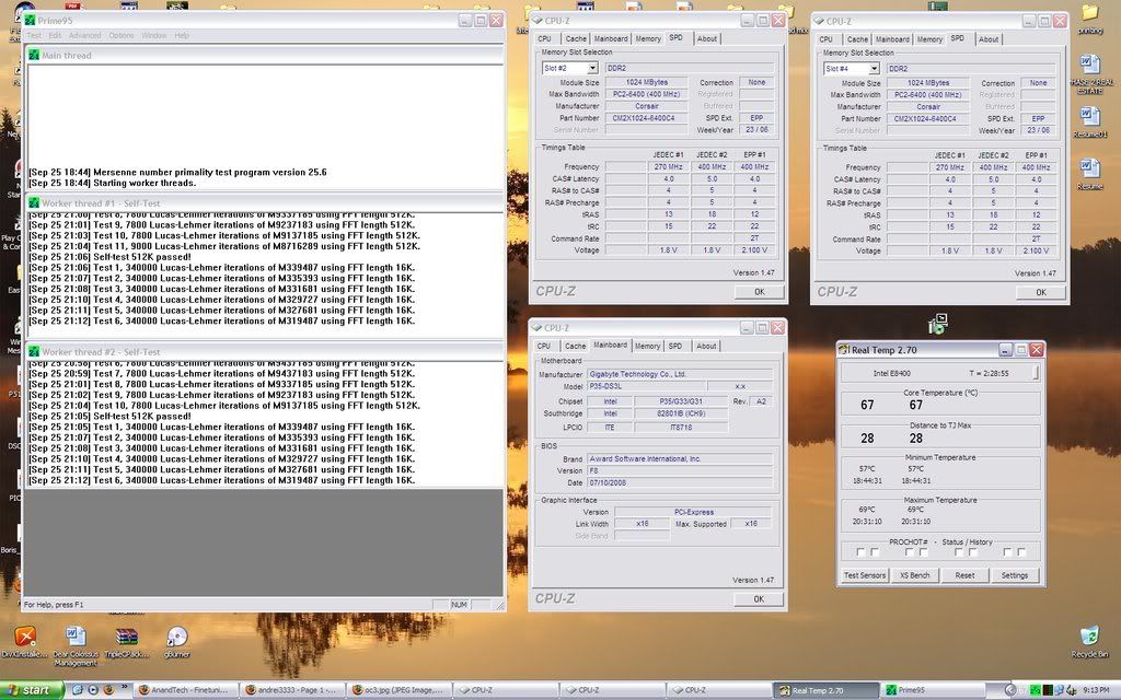

these earlier specs you quoted me as posting are no longer correct as after the tyny meltdown i loaded the bios with default safe specs and started all over again before running those benchmarks
as of 09/25/08 it looks like this
445x9 @ 1.325V (in bios) which is 1.264 in CPUZ not 1.284 as you may have seen due to the crappy low res printscreen
mem freq = 890MHz (1:1)
5-5-5-18
DDR2 = ~2.0V (+0.2)
FSB and MCH voltage is stock
i have not yet optimized my ram to try anything faster, it is rated for 800MHz 2.1V 4-4-4-12 but i want more bandwidth rather than tight timings so i will try to increase it to 2.1V and run around 1000MHZ
HERE is a pic after running PRIME 95 as someone here has requested 2 hours and 20 minutes while fully computing right now after work...same exact results as fas as max temp goes as orthos
http://i150.photobucket.com/al...119/andrei3333/oc4.jpg

Looks pretty good to me. May be the limits I had with that CPU were due to the 680i motherboard. Actually, the more I think of it, I'd forgot to bump up the FSB/VTT voltage. Yup.

That is very ambitious, but why is CPUZ showing 4500MHz while Orthos and coretemp only show 4185 MHz ????
and whats the program on the bottom left used for ? and are such relaxed timings really that necessary ?
