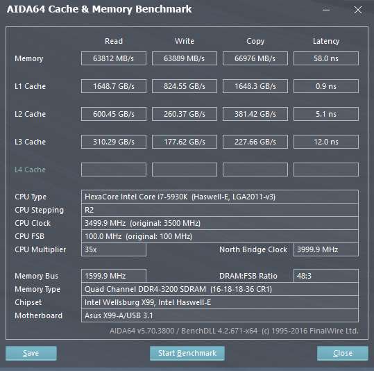

I have just one more suggestion. Ever since I built my newest rig, I was never really able to run my TridentZ DDR4 3200 at full speed. Sure I could boot into windows and run a few benchmarks, but when it came to gaming, it was crash central. Also Windows would eventually BSOD or error out on me.
Lately though after updating my UEFI to the latest version, I tried once again to see if I could run DDR4 3200 speed using XMP. It turns out that I couldn't.....again.
But after doing some research, I had one more trick up my sleeve to play. I disabled XMP, and entered the settings manually. Lo and behold, I can now run at DDR4 3200! :thumbsup:
I don't know what it was about G.Skill's XMP settings, but after entering my memory sub timings and voltages manually, I can now run at DDR4 3200 with stability!
Here's my Aida64 memory and cache benchmark run at DDR4 3200, with the CPU at 4.4ghz and the uncore at 4ghz. So my point is, you might try disabling XMP and entering the settings manually. It might allow you to run your RAM at the frequency it's meant to run at..
The problem is that I tried running looser than the timings already.
MSI I can try the XMP setting or I can use the base 3200 setting for memory speed. If I use the base setup I end up with 18-18-18-48-2T timings where my memory is supposed to be at 16-18-18-38-2T. It couldn't handle 3200 speeds with the looser timings at all.
