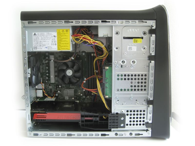

I am considering replacing my AMD HD 5870 after 2.5 years and was wondering how to upgrade my card. I currently own a Dell Studio XPS 7100, which has a mATX case. Would I have to purchase a new motherboard if I wanted to go with something like a GTX 670 or a 7970? Just wondering how to start this entire process. Never done anything like this before!

Go for an HD7950. It's significantly faster than an HD5870 and uses the same amount of power at stock. I wouldn't mess with overclocking it, though, given your PSU.
Also, if your system is like the one pictures, you'll need to remove the VGA shipping bracket to install a new card, and you won't be able to reuse it, most likely.
