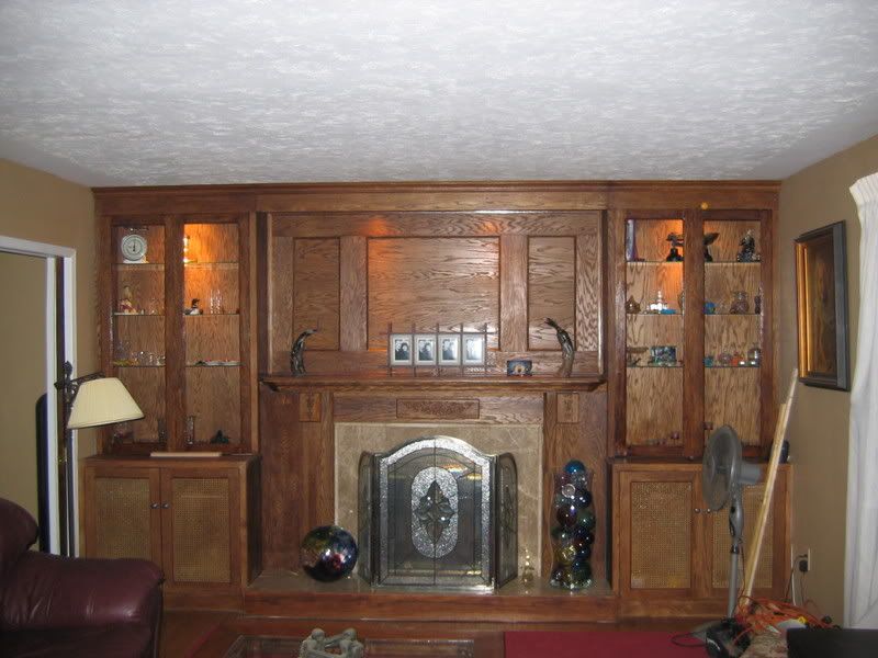

Here's a picture of the room and mantle.
http://i17.photobucket.com/alb...tidus1492/IMG_3424.jpg
From the ceiling to the ledge is 44", the width of that gap is 80", so hanging from ceiling I could get a 90" diag screen at 16:9. From the ground to the ledge is 4'3" (51 "). The furthest couch is about 11'-12' away and then there is a bar with stools about 18' away. Heat isn't a concern above the fireplace, but putting the screen below the ledge in front of the fireplace isn't really an option. This is an old picture btw, and the curtains have been replaced with ones that will block light much better.
How much worse is it gonna look? Is it like DLP vertical viewing angles? This is mainly for my parents although I'll be using it a bit, they aren't videophiles, but are they gonna be pissed if they go projector instead of plasma? The viewing distance is pretty huge.
Also, is there a place in Canada that would let me buy the projector or tv and get it setup and see if its good enough, and if not, let me take it back to get money back even though its opened? Fat chance I imagine..
I don't think your parents would be into projectors. Unless you spend big bux on full automation, it is strictly for tinkerers. Also, they are not ideal for daytime viewing, which I figure your parents would do quite a bit of.
There is no way any retailer will allow you to do that (buy and try) other than Costco. Mind you their policy has changed and you have a shorter return window.
Electric screens are not cheap either. And from your setup I think an electric screen say a foot in front of the fireplace that deploys when you need to watch it is the best you can do, but it will not look very nice. So I think projector is out of the question for you.
Bottom line is if you want the display to not obstruct/obscure the fireplace, you are going to have to live with a smaller display.
