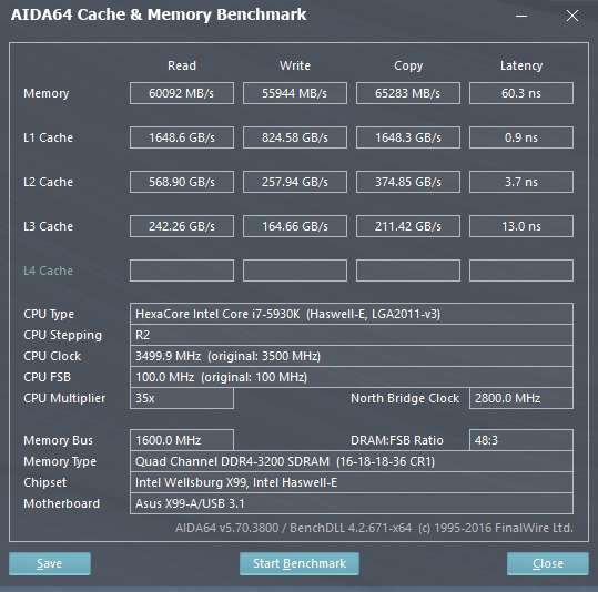

This was the benchmark with my old kit:

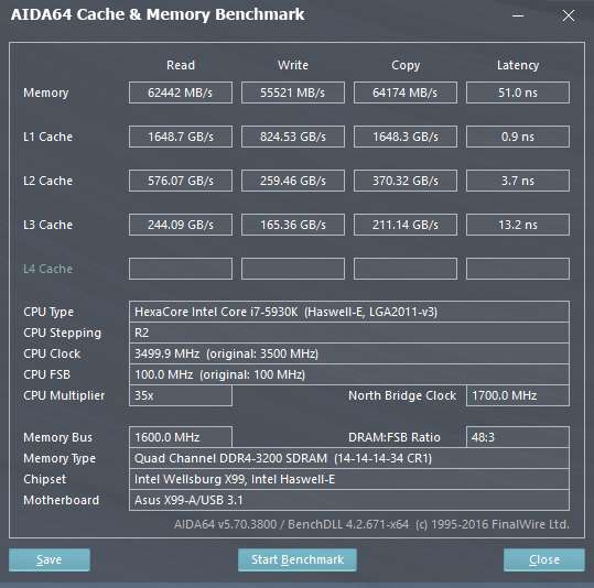

And this is the benchmark with my new kit:
What the hell? My read, write and copy are lower with the new set despite the much lower timings. Only latency has improved significantly..
Everything is the same, including the core and uncore frequency which I have set to 3500 max.
One thing I knew beforehand but didn't think it would matter, is that the new kit is actually a DUAL CHANNEL kit, despite having 8GBx4 DIMMs. My original kit was quad channel however.
My theory is that since the dual channel kit has unmatched sets, it's somehow messing with the performance of the kit in quad channel mode. I mean, it's not a huge difference mind you, but it's significant.
Any ideas? I'm going to call G.Skill in the morning and ask them either way though, but this is bugging me.
Well, all I can say is that your latency in nano-seconds for the new RAM is better than it was for the old RAM.
As I remember, there is a secondary latency which defines the overall delay in clock-cycles for a memory operation and including the sum of clock-cycles for the four primary latencies. It is possible to shorten this secondary latency and improve performance somewhat. I just forgot what it's called . . . . But it might vary with make, model and other features between old RAM and new RAM.
You're talking about the row refresh cycle time. I already checked that, and on the older kit it was slightly lower than the new kit. Anyway, I put the same timing in for both kits, and whilst the benchmark scores did improve, it's not the main reason why the read, write and copy are lower.
There's another sub timing setting(s) that I'm missing. Of course, the easiest most pain in the ass thing to do would be to simply reinstall my old kit and then use it as a cross reference for the new one, but that would require uninstalling my video card, and then uninstall my heatsink fans and I'm too lazy to be honest 😀

G.Skill tech support gave me some settings to try out. I haven't finished tweaking them, but here's an example of their impact:
Even lower latency, and everything else except the copy speed is up to par with my original kit. These latency scores are insane for quad channel! 😱

This was the memory benchmark for my old kit using default timings but with the uncore at 4ghz. As you can see, the write bandwidth has increased tremendously compared to even running it at 3.5ghz.
The problem is though, is that with Haswell-E, combining high uncore frequency and high DDR4 speed can result in serious instability.. That's why I don't bother overclocking my uncore past 3.5ghz any more, as there is hardly any real world benefit, and you can have serious issues...

Yep, as evidenced in my final tweaked timings. As you can see, read went up by 1GB/s, but copy had a large increase of 5GB/s.. Latency also dropped slightly as well, but not significantly.
Write performance remained the same because as I said earlier, it's linked to the uncore frequency..
This benchmark was run with the uncore at 3.5ghz.
