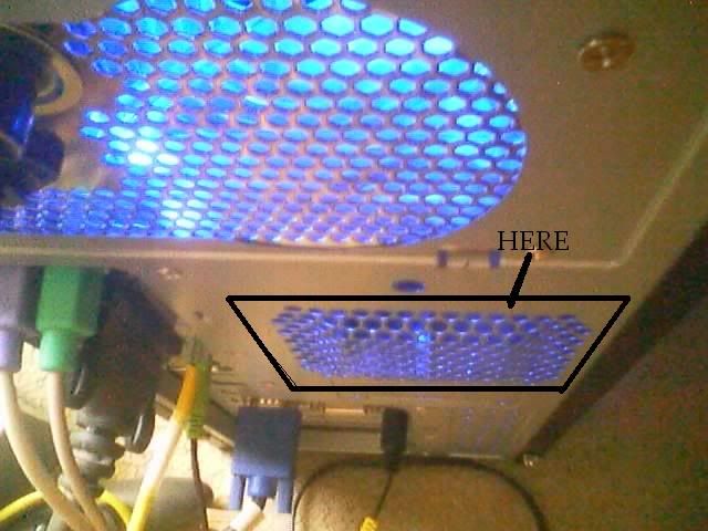

i want to drill some holes and put a 120mm on the back here but i dont know how that will mess with the air flow being that the psu's 120 blows down right there and the side fan is close to it also
Well, you can but you're not going to see much gain, if any. You may want to consider blocking the psu fan from the rest of the case, make it draw from the front. Then mount your 120 on the rear to handle mb generated heat.
Otherwise, you're just at it for kicks because the gains will be limited. You'll need to go to water or phase change to see a huge jump.
Ummm....Do you really think your PSU fans are blowing into your case?
Industry standard is for PSU fans to exhaust their heat.
Rear case fan should exhaust also, making both rear and PSU fans pulling heat away from the CPU area.
