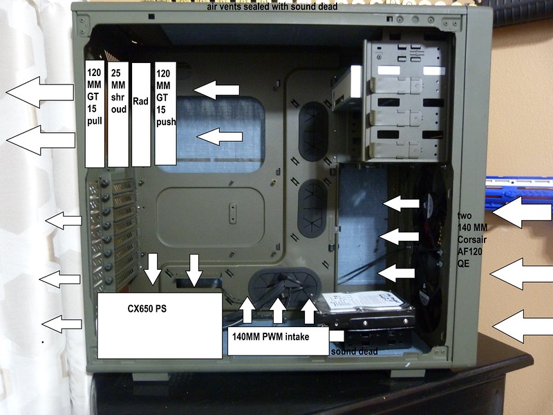

This is my idea I want to do :
or this:
here is why I have no side fans:)

This is the configuration that Corsair recomends:
This is my idea #2 using the above setup;
what I want to do #3:
or this:#4
"Gun! Everybody hit the deck!" D: What's that on the wall: an AR-15?:D
Seriously, though. I think you have the right idea, but it boils down to this: What goes in -- must come out.
I'm skeptical about an H60 being sufficient for a Devil's Canyon. Maybe you don't plan on overclocking it though . . . Just my opinion, but I'd pick a double-sized AiO like an H110 for this. And the problem is fitting it in that case . . . ah . . ammo box. . .
I notice this case is vented on the bottom -- something I didn't see at the Newegg showcase for the C70. You'd fit a PSU in the bottom rear, but there's no drive-cage obstruction in the front. wondering if you could fit a 240mm AiO forward from the PSU.
But I agree about blocking off unused vents, as you plainly seem intent doing to the top vents. [or am I wrong?]
It might not much matter if you're pushing warmer air into the case with a cooler at intake, if there is sufficient airflow in and out of the case.

Thanks for the reply. I haven't built the board or ran this yet, and I don't plan on overclocking it. The top of the case will be covered with a bunch of linked .50 cal ammo, cus what good is an ammo box without ammo?
I don't know if the hoses on the 60 will reach the front, but I can check that out. They might reach if I move the drive cage to the bottom and mount the rad above.
This will blow the hot air on the GPU, but the Asus 980 with the ref cooler that blows out the rear and runs pretty cool. ( not overclocking it either)
I can make a shroud to direct the air from the rad up away from the GPU but I don't know..............

Ok, change of plans. Removed both drive cages and ordered 2 HD mounts.
I am going to mount the SSD's in one and the back up 3.5 in the other and mount them on the floor in front of the PS. Ordered 2 AF140's HP and will alter the case to make them both fit in the front. Going with the stock H60 fan, sealed and with a 25mm shroud pulling out the rear of the case. Top and bottom vents will be sealed, forcing the 120+ cfm from the 140's out the back. We will see how this works.
With the drive cages out of the way, there should be good airflow across the board and GPU. I will update with the results. Thanks for you help guys!

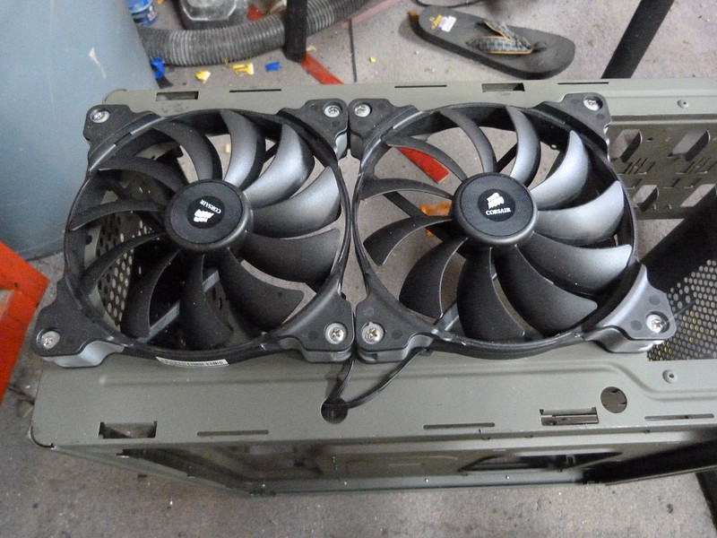

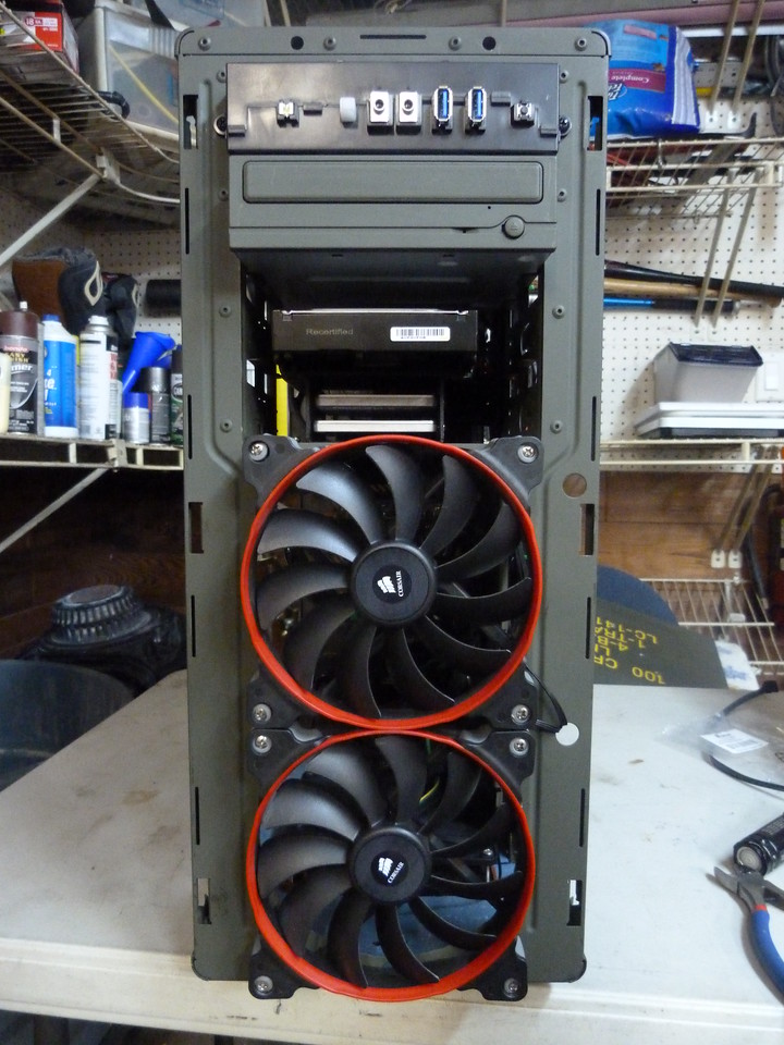

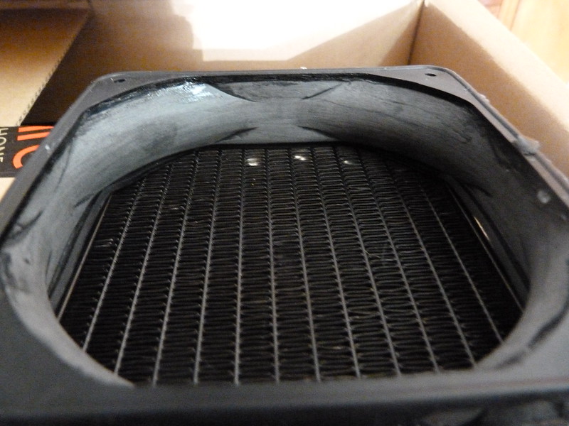

Here is what I came up with.
I have modded the front to fit two 140MM Corsair QE fans and opened the back of the case at the exhaust to eliminate any restrictions. 2 Gentle Typhoon AP-15's 120mm in a push / pull on the H60 with a homemade shroud.
Found that the Corsair stock H60 fan dosen't fit flush on the radiator, it has a small gap on all 4 sides that will hurt the airflow in a pull config. Ordered the GT as they are completely square and should have as better seal. Made a shroud and installed with a rubber gasket, still has a small gap. Sealed the shroud to the rad with silicone.
As you can see, no window = I don't give a s*** what it looks like on the inside.:)
