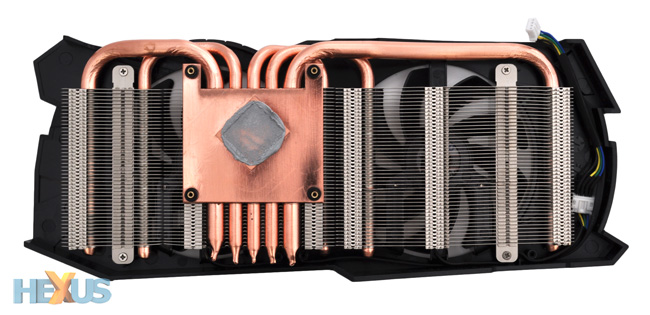

I haven't actually looked at the fan/card too closely yet - Is it a big deal to replace the fans on this card? Anyone have any experience doing it? Do I need to remove the entire cooler off the card?
I would fill out a support ticket and see if they can just send you the fan shroud setup, especially if the card is still working properly.
It looks like only four screws need to be removed in order to remove the fan shroud assembly.

Personally I wouldn't even bother with the RMA. Takes so long..... I'd strip the junk fans off and slap a couple arctic 92mm on there and call it a day.
