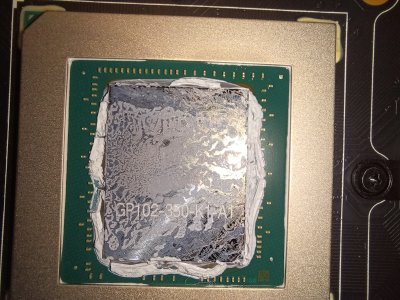

Following up for those that are curious.
I repasted my GPU last week with Arctic MX-6, the OEM paste was almost all dried up and pushed out to the sides. You can see for yourself in the attached image.
So far after about a week of use I've been getting cooler averages. I run my GPU in silent mode and been getting mid 40's, low 50's Celsius while idling and browsing videos, before it would usually be mid 50's.
During heaving gaming it would peak around 74-75, and average low 70's, better than before where it would be closer to 80.
