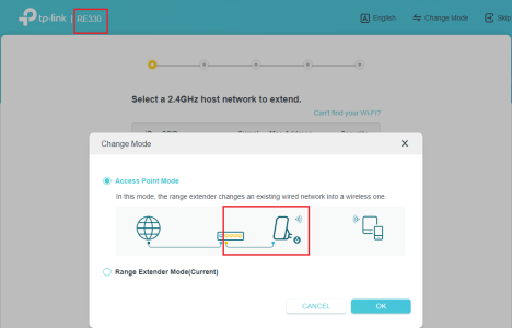

AP mode means it's wired between extender and uplink device (could be switch, router, phone company wireless hotspot devices with ethernet port)

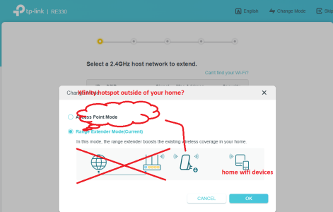

I don't get it.
Are you talking about Xfinity Wifi hotspot that's supposed to be accessed outside of your home but you want to connect it using TP-Link RE330 at home wirelessly then share with other wifi devices?
On the other hand, AP mode only uplink to your (wifi) router with wired ethernet cable. In AP mode you don't connect RE330 to any other devices (including WiFi router or any hotspot wirelessly), so you don't have any SSID to connect to. In AP mode, RE330 has its own SSID (can be set as same or different from existing wifi router's SSID) that other wifi devices can connect.

I don't get it.

The AP mode seems already working for RE330 extender, exactly what do you want to achieve? And are you Xfinity customer at home and using their wifi router/gateway or you have different ISP?
