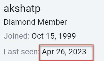

Cheers mate will do, hopefully the owner of the thread does see it and shares their diagnostic
Doubtful. 15 years is a lifetime for a forum. Check for user activity.
