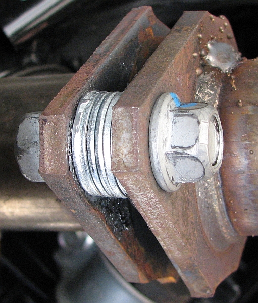

Exhaust Washer Mods
Eureka
I've recently come across this...
I mean this:
The common things I hear about:
1. It sounds bad
2. It is an exhaust leak/bad on system
3. Carbon monoxide fumes
From what I understand about cars though
1. Subjective
2. You do it far enough back (right before the muffler) that you still have enough backpressure from the rest of the piping. Isn't this the same as a muffler delete anyway?
3. This is done way past the cat so all the fumes should be catalyzed, and it's far enough back that you're inches away from the exhaust tip anyway
Apparently it's a thing.. you space out the pipes between your muffler and downpipe to get some noise going.
I've read a lot of debate about it. It's intriguing.
If you do it right before the muffler, shouldn't it be mostly catalyzed by then?
Reactions are catalyzed. I don't think it's proper to say a substance has been 'catalyzed.' It has been converted to another substance by a chemical reaction.
That bit of nit-picking aside, I don't think harmful gases like CO are at a high enough level in modern cars to make an under-car exhaust leak a serious concern.
You would probably need a combination of poor running condition and a way for exhaust to enter the cabin (unsealed hole around a manual shifter seems like a common one)...the kinds of things that kids that would do a 'washer mod' probably have, actually...
If you want your exhaust to be louder, get a muffler that...muffles less. Or replace one or more mufflers with a piece of pipe. It's not that hard/expensive. I still might hate you for it, but I'd wouldn't laugh at you quite so much. Spacing pipe connections apart with washers might as well be drilling random 'speed holes' in your exhaust.
You forgot #4: looks ghetto as hell.
The people that say it sounds bad are spot on, because I am going to guess this "mod" is done on low displacement 4 cylinder engines, which sound annoying when their exhaust systems are forced to make more noise for the sake of making more noise. A heavy breathing V8 does not need crap like this to sound good, and when you get into exotic 10 and 12 cylinder engines it is probably completely unheard of.
If you really want your 4 banger to sound nice, then buy an exhaust system set up for it, and for the love of god have some forced induction in front of it. You need to be making 125hp per liter or more to even justify a noisy 4 cylinder, in my opinion.
Agree with Gillbot.
That's probably heinous for exhaust flow... sudden, large, increase in flow diameter and then a re-entrant inlet...
Also, it's DEFINTELY horrible for exhaust structure... I bet the flanges like to snap off shortly after this 'mod'.
Not to mention hot exhaust gases like to melt/damage stuff, and the various acids created by the exhaust will ruin everything down-wind of the gaping exhaust hole.
They might be pre-cat; but after cat, CO will be pretty much zero. With modern close-coupled cats, CO is going to be pretty much zero unless the leak is in your headers.
If you have tail-gas analysis emissions inspections, then any kind of leak in the exhaust will be a fail. The gap will suck in air, and a tail-sniffer emissions analyser will read a falsely high lambda. Lambda > 1.003 is usually a fail, and corresponds to a very small leak.
