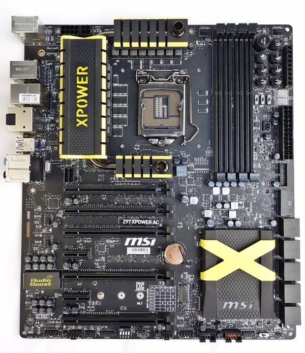

Was also looking at the MSI Z97 Xpower AC:
It also has a PLX bridge and the slots can be:
For single card use slot 2 that bypasses the PLX and it's 16X direct to the CPU.
For two cards, slot 1 and 4, so plenty of spacing.
And it can have up to 4 gpus.
It is a bit cheaper than the EVGA Classified.
What's your input?
Cheers!
