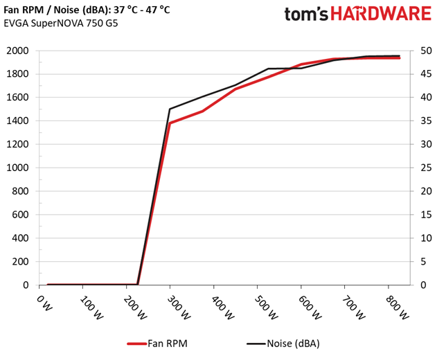

It's possible other reviewers might like this unit better (or the smaller units perform better than the larger units). However, when I saw the fan noise on page 2, I knew this fan would be a pass for people who care about noise. For only hitting 210w on this unit, that is a very aggressive fan curve.
The passive operation goes up to around 210W load. With >760W load the fan gets too loud, exceeding 50 dB(A), so you will probably need earplugs if you plan to stress this PSU.
aHR0cDovL21lZGlhLmJlc3RvZm1pY3JvLmNvbS8yL1AvODUwMjczL29yaWdpbmFsL1Jlc3VsdC0yNC0zN19GYW5fUlBNX05vaXNlX0dyYXBoLnBuZw==

My biggest complaint about the G5 lineup, outside of simpler topology of course, is the way they tuned the fan profile. A top-shelf PSU should not need the fan to go from zero to 1400 RPM at little more than a 200w load, along with 40 dBA+ of noise.

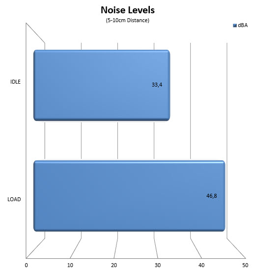

OK, now I am just confused: https://www.eteknix.com/evga-supernova-850-g5-power-supply-review/9/
I know different sites can rate components differently, but Tom's states this power supply is very loud, with the fan going to 1400 RPM just over a 200w load. However, eTeknix states the fan doesn't begin spinning until the unit is at 80% of its load capacity, and highly recommends this unit.
It may sound at this point that we’re in danger of waxing lyrical about the EVGA SuperNova G5 and if we are, it’s only because it really is that good!
In terms of a power supply, from the most basic to advanced consumer, this is practically perfect in terms of what it offers and, more importantly, delivers.
The EVGA SuperNova G5 is bulletproof in every regard you could potentially be critical of a power supply in and, if you were to ask me what power supply you should buy today, I’m pretty sure this would be high, if not top, of my list!
With the eco mode looking to only operate the fan when needed, this again was a little unusual. Why? Well, it only seemed to deem running the fan necessary at 100% load. As such, if noise is one of the primary concerns of your system design, this power supply could definitely play a huge role in that ethos.
Throughout all of our load tests, the fan remained at a largely constant 930rpm. Despite this, however, the fan itself was barely audible and as such, is no cause for concern as far as we can see.

Maybe eTeknix got a revised unit with different firmware for the fan?
Could be.
What's odd is one says the fan comes on roughly a 20% load (which is on the very low side), and the other says it doesn't kick on until an 80% load (which is extremely high).
Otherwise, something is way off (or one of the sites could be improperly testing or reporting incorrect info). Hopefully a few more reputable review sites will release a review on it, and clear up some of this confusion. I'd love to see a JonnyGuru's site review on it, but that likely isn't going to happen.
Usually, the reviews might differ in recommendations a little, but it usually isn't this wide. Tom's basically says avoid it all costs, and eTeknix gives it an Editor's Choice award.
