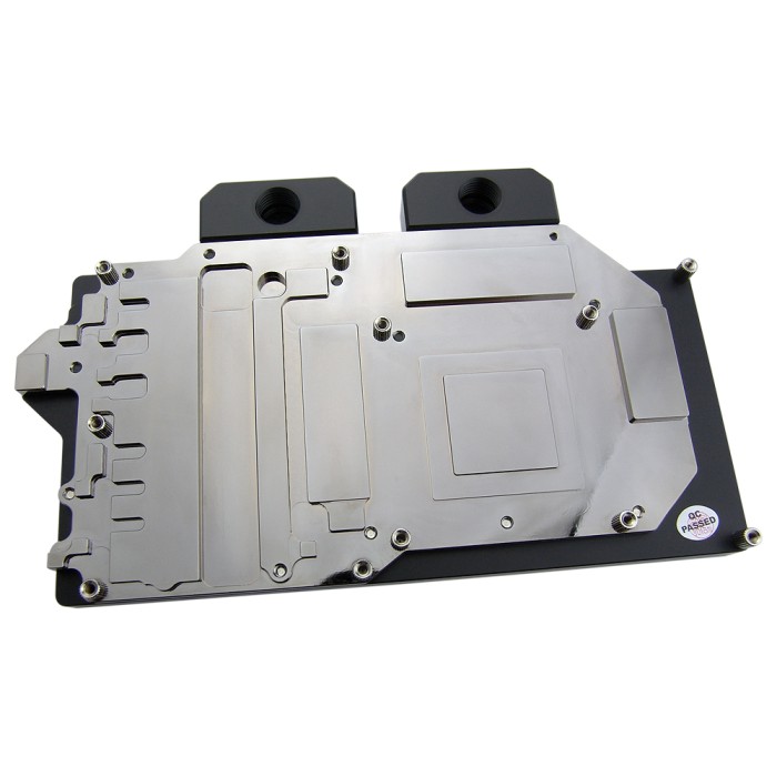

My EVGA GTX 980 Hydro Copper block finally arrived and I haven't seen anyone else post pictures of it so I figured I would.
Its pretty nice looking. I wanted a full cover block even though the rest is just an acrylic piece but I also wanted the lighted EVGA logo and light up block.
Pics are of the un boxing. Ill have it on the card tonight with some info on how it cools my 980 SC ACX2.0.

This block is made by EK, and im glad they switched. Ive never really been a fan of the swifttech blocks. I will say, compaired to the rest of the heat killer blocks and the block on my 690, this is a rather light block but that would seem right as its not a "full" coverage block. it covers the areas it needs and that's about it. It doesn't extend fully to the edge of the block.

however to be honest, im willing to wager koolances being superior.
You can tell by how complex the underside plate is compared to eK with better coverage:

also keep a very close eye on that nickle plate.
I do not trust eK with nickle blocks.

I know your thoughts, I had another EK block that was nickel plated that I saw some flaking after a while.
I do know what you mean with the block though. I compared the block to the ACX 2.0 cooler that was on it and saw the water block doesn't quite hit everything the ACX cooler did but it covers the important chips on the card.
