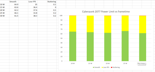

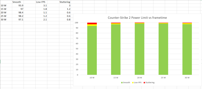

With that out of the way, let's get to the testing methodology. I test two games that are on the opposite sides of the CPU/GPU intensiveness spectrum: Counter-Strike 2 and Cyberpunk 2077 (without RT of course). The reason for choosing these two is that they are easy to benchmark with repeatable passes. I run a bot match on Dust II in CS2 - capture starts after spawning and when the countdown timer ends. I use the same route to move around every time and engage with the enemy bots during the end of the run. For CP2077 I simply use the built-in benchmark.
For settings, I use 1600x900 resolution is CS2 with medium-derived settings using CMAA instead of MSAA and forcing FXAA on through the NVCP. This allows me to run the game at a reasonable 100+ average FPS. For CP2077 I also use medium-derived settings, at 720p with Intel XeSS set to Ultra Quality. I actually cap the FPS at 30 while playing the game, while the benchmark obviously runs at uncapped FPS.

I test at PL1s ranging from 10-30 W, in 5 W increments. 30 W is the maximum PL1 set by the Dell BIOS with the highest performance mode. The green bars represent what % of time the game spends above the threshold of the target FPS, which is 60 in case of CS2 and 30 in case of CP 2077. The yellow bars show time spent below the threshold, while red represents the stutters. The benchmark runs last for 60 s.
As it is clearly observed, setting PL1 at or close to PL2 is not optimal. In CS2, the optimal value is somewhere around 20 W, or 0.67x PL2; while in CP2077 the optimal value is 25 W, or 0.83x PL2.
