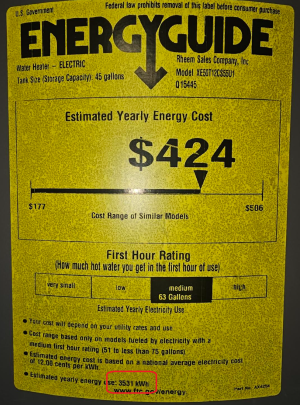

I have 3 year old 80 gallon water heater. Looking at the label it states estimated yearly energy use is 5392kwh.
Does that imply on daily basis the water heater uses 15kwh ?
My electric bills are through the roof and I have started trying to figure out if this water heater is the culprit!! Since I have been monitoring the HVAC refrigerator and other major appliance usage.
When I look at my electric utility bill...the app shows every time we take shower the kwh jumps from roughly 1.5kwh to 6-8 khw...this is the main reason I think the water heater is the hoggin a big chunk of our bill.
For reference the water heater is state water heater proline series installed in 2021. Model # EG6-80-DRRT 200
240 VOLTS/4500 AMPS
any inputs on how good this water heater is in terms of energy efficiency or energy hogging! Thanks for your feedback

Electric water heaters use a lot of energy, it's the nature of the beast.
Your listed volts/amps are incorrect, there is no way on that thing draws 4500 amps. Perhaps you meant watts?

Yup ...you are right ..it's 4500 watts!! Sorry about that!!

I used an energy logger on my 40g water heater. For 2 people I was using 7-8kwh/day. Time for navy showers!

It has a (actually two but only one runs at a time) 4500W heating element(s) so completely normal and typical for it to raise the reading 4.5kWh.
It only does this long enough to get the amount of water used, back up to the preset temp, and keep it there (which uses much less, averaged out per hour).
There are several variables like incoming water temp, the temp you set it to heat to, and amount of hot water you use. A smaller heater can use a bit less power but if you run out of hot water or it takes too long to recover, it was too small.
The efficiency is going to be pretty similar to any other tanked electric water heater under the same variables/use-scenario mentioned above. Some use-scenarios can save around $50/year switching from electric tanked to electric tankless, particularly if not much hot water is used per day, but there is a significant cost to install tankless, and that's usually less than 10% saved of the total power consumption. You're still heating X amount of water you use to Y temperature.
If it were me, I'd ride it out with what you have because it's only 3 years old, and then when it fails, decide if it's time to go tankless. This assumes you don't have natural gas on premises which can be the cheaper option whether it be for a tanked or tankless heater.
You should notice a spike in power consumption when anything else with a large motor or heater kicks on, like if you have an electric stove, clothes dryer, and especially HVAC (depending on climate and HVAC system capacity, and of course, the max/min temps you set it to).
