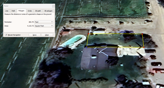

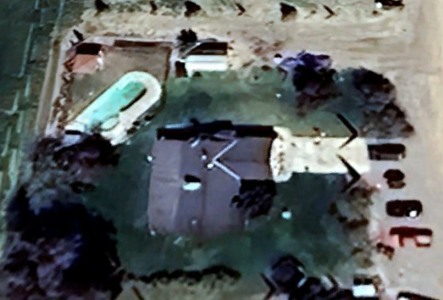

Based on that picture, maybe 3000-4000 sq/ft.
Yea CV.
Using Earth, it's measuring 4100 sq. ft. for just the northern section. Obviously not completely accurate. After looking at it though, their house can't be more than 2k and that measured area looks equal to the house.
Yea CV.
Lived in that nasty hot, dry, dusty place for 25 years...that picture SCREAMS "Valley."
