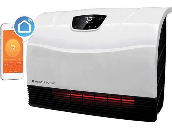

You'll have plenty of margin to run a 500W heater off an existing 15A, 120V circuit, as long as nobody is trying to simultaneously use a 1500W+ hair dryer on the same circuit. The wall mount heater (that type) linked seems a good option given the details we have so far.
