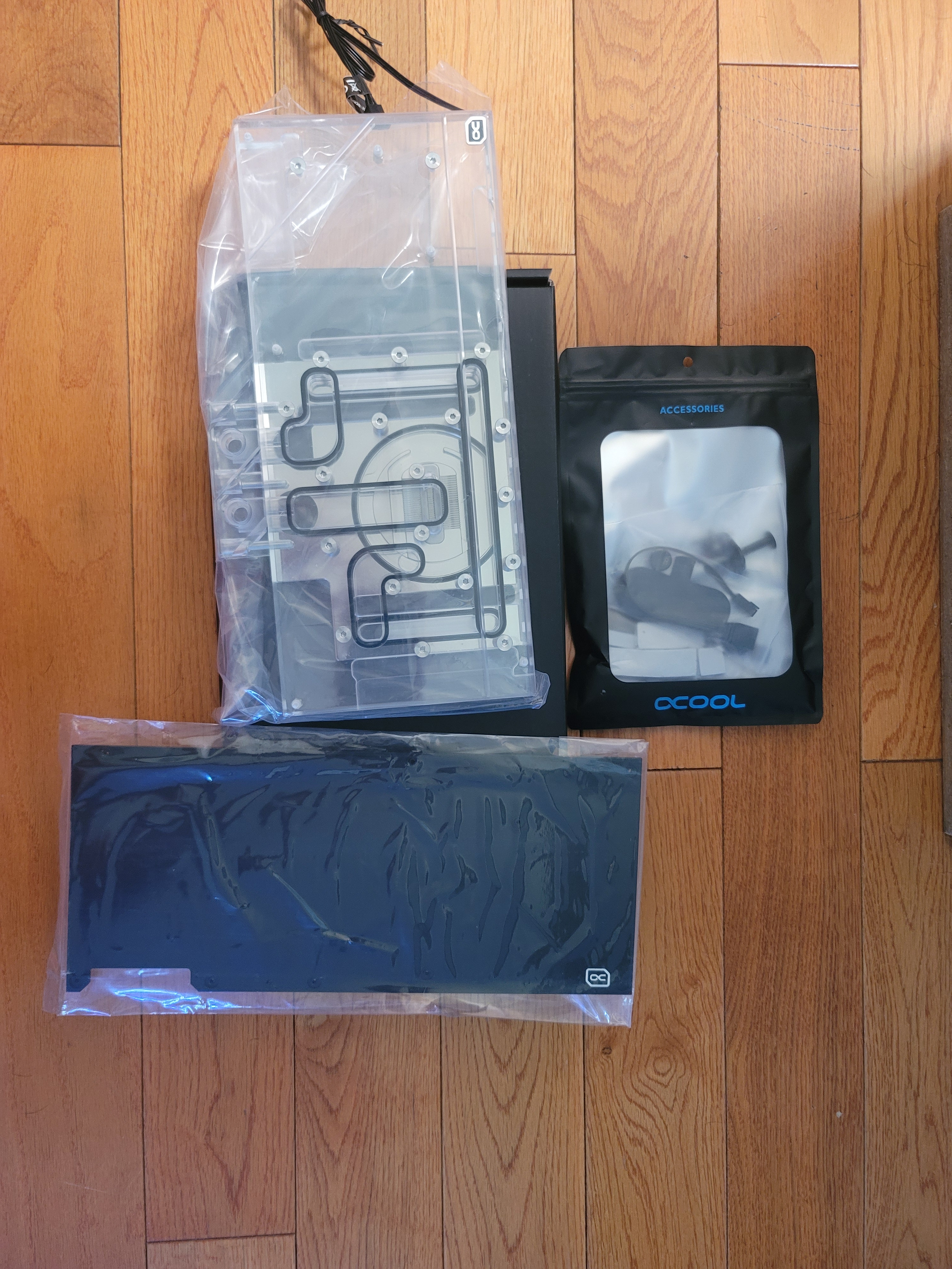

what about alphacool?
Its a nice block, even comes with a blackplate.
It also uses injectors like eK. (So make sure you get in your Inlet and Outlet proper.)
And they perform pretty darn nice.
And can i also say its probably cheaper then both the eVGA stock and eK.
BTW this is for 3090 FTW Ultra
Which i am going to bet is going to be the same block for your 3080ti.
Here is my current idle @ 78F ambient
overall i think you should give alphacool a option. I am pretty glad i was forced on it.
