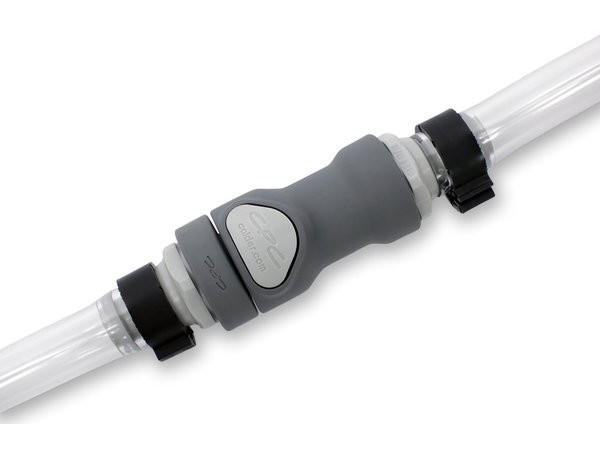

  2. Will EK continue to support this set into the future? This is probably the hardest question to answer, but it's not hard to solve the problem. Fortunately, the MLC Phoenix set uses the exact same quick disconnects that EK sells in their store (except in black), so you can just buy quick disconnects to attach a non-MLC unit to the loop. I actually got a few off eBay for a really good price!

Also as i said those qdc's are from CPC colder quick fittings.
you can source them at usplastics, however they are sort of pricey at ~23 dollars per complete set.
https://www.usplastic.com/catalog/i...Q7Pn7OXA9uf2L8L9N-K9al-Gmw6iRBkQaAuEuEALw_wcB
remember u need both male and female...
Yep, I actually bought three of them off eBay. It cost me about $15 each, which is pretty decent for a quick disconnect. I think EK is selling them for $18 right now, but shipping to the US really adds to the overall cost.
