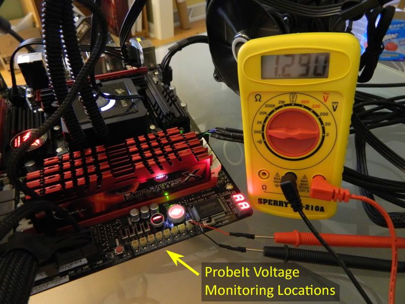

Just to re-visit the hardware setup here, I've got an ASUS Maximus IV Extreme-Z that has these lovely ProbeIT voltage monitoring connections built right into the motherboard so I can track the CPU's Vcc in realtime with an external voltmeter.
In addition to that "feature", I've got your standard run of the mill Kill-a-Watt power meter along with a generic ambient temperature probe.

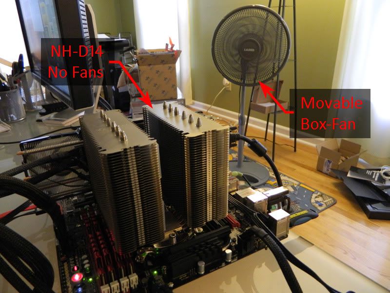

To that end, what I did was I connected 4 fans to the motherboard headers (for power-draw continuity purposes) but I set the fans off to the side so they weren't actually being used to cool anything.
Then I setup an external box-fan, the kind you'd buy at Walmart or Home Depot, and used that to blow air across the computer and through the fins of the Noctua NH-D14 heatsink. (which was lapped, along with the CPU, details here if interested)
^ The box-fan (not really a box-fan as you can see, but I forget the technical name for this thing) can be seen in the background there.

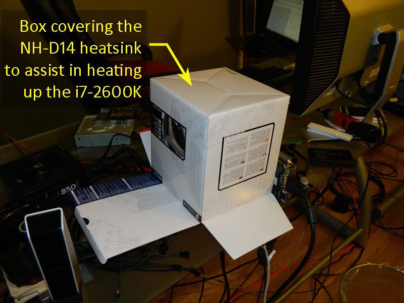

What I did to control the CPU temps was I started IBT for a silly long session (300 minutes) with the boxfan close to the NH-D14. Monitored temps with real-temp. Once the temps leveled off, with the computer fully loaded with IBT (4 threads, affinity locked to physical cores) I would physically move the box-fan a small distance away from the computer in increments of roughly 6-12 inches at a time.
Then I'd let the temperatures level off, I'd record the temperature and power-consumption, and move the fan again.
I would repeat this process until the CPU hit is TJmax of 98°C and started throttling.
In cases with low clockspeed and/or low Vcc, where the NH-D14 was actually sufficient to passively cool the CPU at a temperature under the TJmax limit, I would go to the extremes of putting a card-board box over the top of the NH-D14 to force the issue of getting the CPU to heat up:
In the case of the 2600K operating at 2GHz and 0.820V, I simply could NOT get it to heat up to 98°C even with the box covering the NH-D14 and swaddling the whole thing with blankets to try and trap the heat :eek: (it maxed out around 86°C in that specific test)

My PSU is the corsair gold ax850 (cmpsu-850ax) which has ~89% efficiency across much of the output range, and only varies by about 2% efficiency across the entire range:
(^ that's Corsair's tech data there)
As you can see, we are looking at loads on my PSU that range from ~220W to ~380W, meaning the PSU efficiency is ranging from ~90% to ~91% across these tests.
The inefficiency of the PSU's AC/DC conversion is going to be absorbed into the "System Power" number - the 130W number - along with the ram, SSD, mobo chipset, and GPU.
The temps of these components was mostly held constant as the components are sitting on a bench and not enclosed in the case.
I did not include the data and photos here, but I periodically used a handheld IR gun to measure and monitor temps of various components throughout the days and weeks of tests here.
^ the red dot you see on the NH-D14 finstack is from a built-in laser pointer on my IR gun, shows you exactly where you are sampling the blackbody radiation from for purposes of establishing thermal temperatures.
Also in this photo you can also catch a glimpse of the fan array of dummy fans I setup for power-consumption continuity purposes. The fans were normally placed on an adjacent platform below the desktop level during the tests. There is a fourth fan not shown in this photo, it was placed on top of the PSU to keep the PSU temps minimal while avoiding the PSU needing to kick-on its own internal cooling fan (which would have resulted in a non-linear power-consumption response for the system).
Its not perfect, but then again given the budget and the quality of the tools used (none of this is industrial/professional grade, this is more your weekend DIYer enthusiast type project) it's actually kinda surprising to me how decent the results were.
