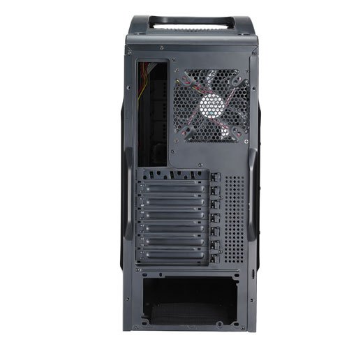

When looking at cases that are for water cooing you need to look at rear images. You need space above the MB for a Rad and fans. It's easy to get an idea of clearance by looking at images.
Not much space but maybe a thin rad would fit. MB heatsinks or rams may eliminate the possibility. Anything less than this clearance is a no go most likely unless you mount rad on top which kinda looks tacky.
You can quickly eliminate choices this way. Easiest way to judge is by the backplate cutout as it's at the edge of the motherboard.
