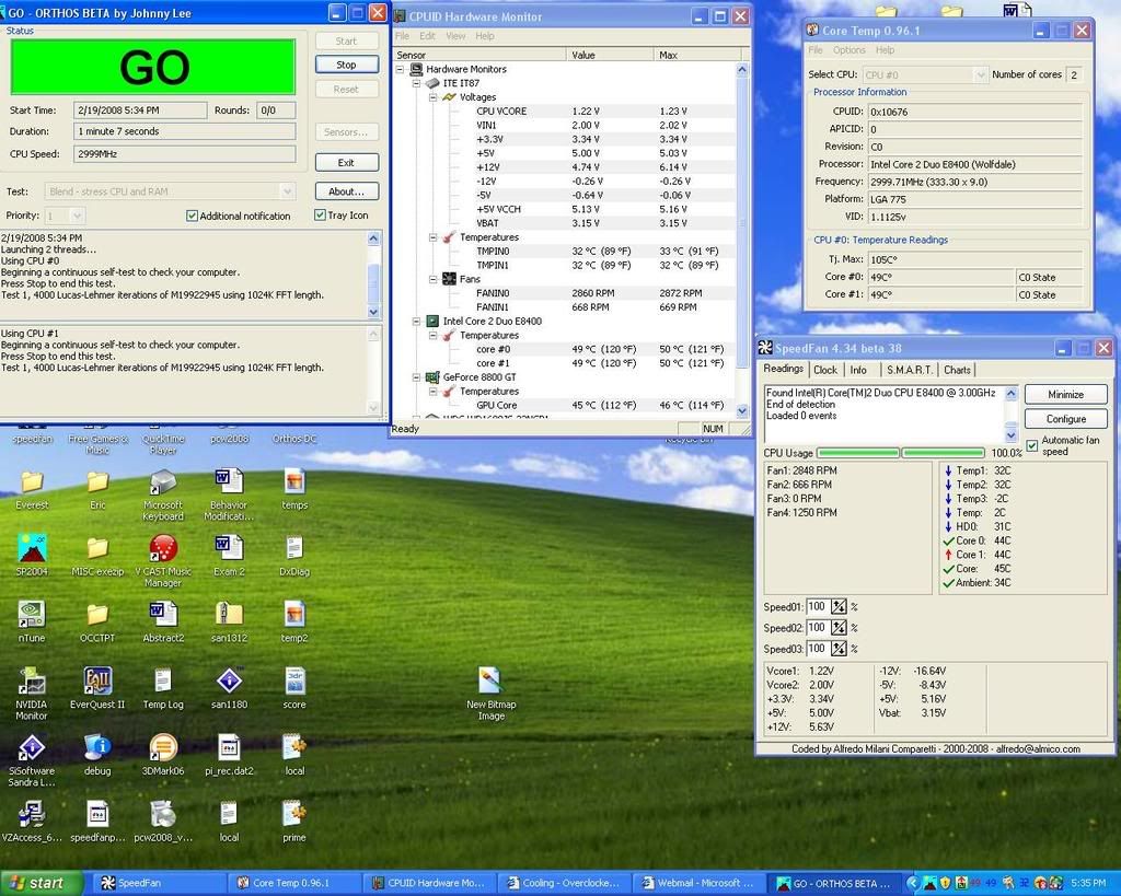

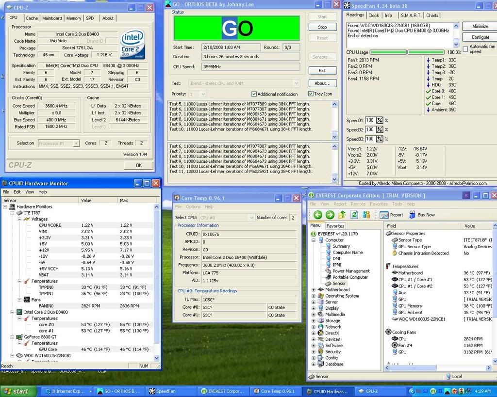

I was running Orthos on a longer run. I stopped it at 17 hours stable. Anyhow, this is from earlier in the run, and I was wondering if my 9700LED is doing it's job. My other processors were amd, so i am unsure of the temp range for c2duo wolfdales, and I know there is some issues with temp readings.
Temps picture
I am just running this out to everyone to ask how they see my temps. I dont want to risk burning up my system, and i dont want to run "along the heat wall" either.
53C is a little bit high, but not really anything to worry about. I aim to keep it under 60C, but I'm happier under 50C.
It's fine. Conroe processors could take up to maybe 70C before most people backed off (upper temperature limit). Not too sure about Wolfdales, but they should be fairly similar.

Looks very normal and acceptable. And your description of how temps rise and drop is not unusual either, CPU's heat up and cool down really quickly. You should be good to go up some more if you want

After the first minute..well honestly the first 30 seconds, the temps reach roughly the same temps as they do when i am at the 3 hour mark, or the 17 hour mark. Maybe 2c higher.
Let me show you what my temps read, being about the same ambient as last night..
2 minutes into the test.. the temps are pretty much what they are 3 hours in, and then 17 hours in. It is a really fast climb.

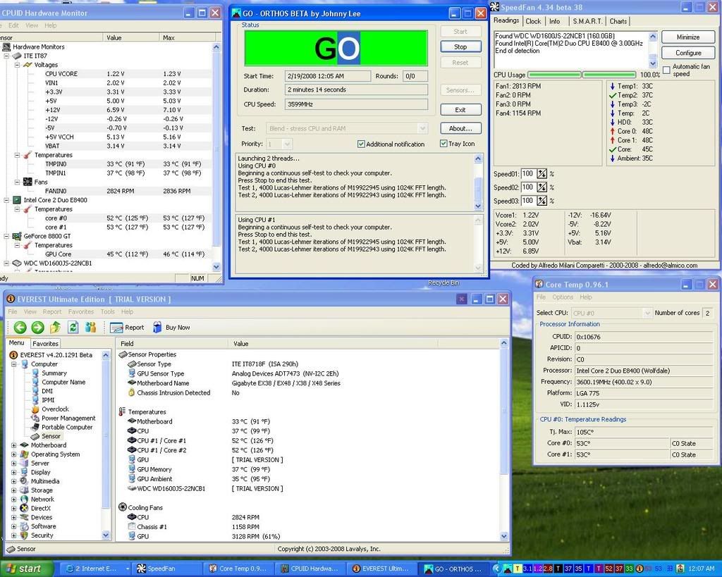

Temps 2
They lower within a few seconds to almost normal idle temps, so the air flow seems to be good.
I knew temps rose, but I had figured that temps would rise alittle, and then after so many hours rise some more, and after 17 or so be alittle higher. This isnt the case. Just seems to be a solid jump in the beginning, and then nothing noticable even after 17 hours of both cores 100%.
Perfectly normal. The issues people are having with their E8400s are processor reporting either the same temps no matter the load, or people getting 90C even on water cooling.
Yours is perfectly normal. My Q6600 idles 27C and loads up to about 43C on the hottest core. It takes but a few seconds to get there and come back down. My old Opteron 165 was the same.
If i could make a suggestion... use coretemp 0.06 not 0.95.1. There are apparently some issues with the newer version.
Temps 3
