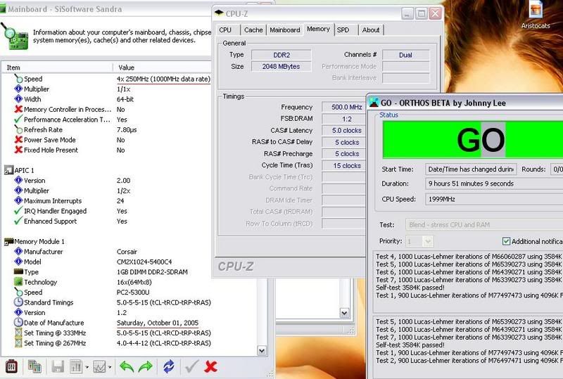

I think before you start assuming that your ram tops out at 800mhz, you should test it out first and then make your buying decision.
My DDR2 PC5400 (675mhz) went to 1000mhz at 5-5-5-15 timings at 2.1V => pic
