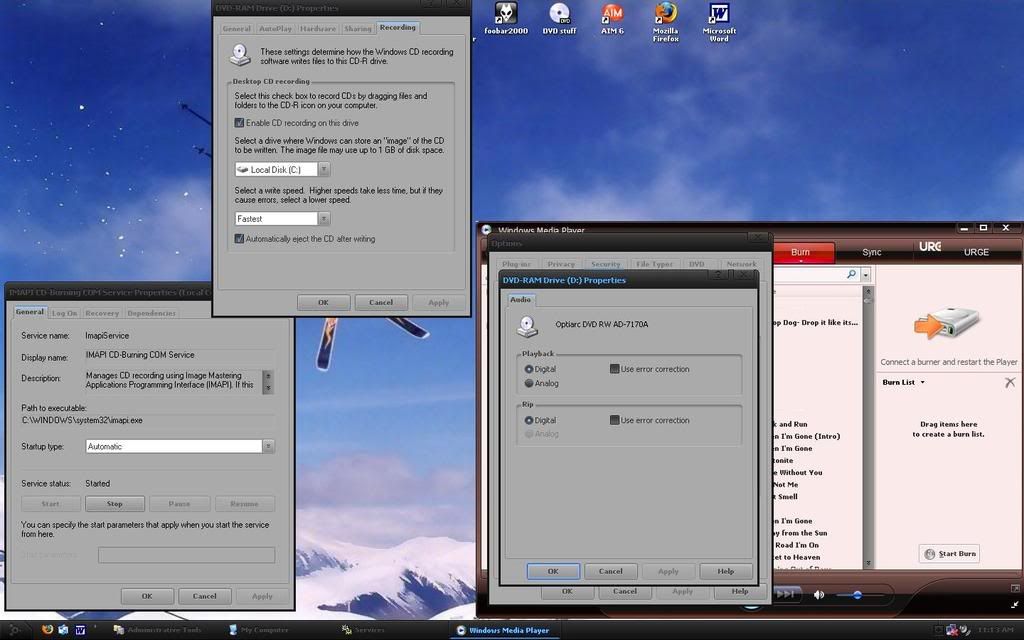

ok I found out how to modify the registry so that the recording tab is shown and I checked everything but wmp still says "connect a burner and restart the player"
I just tried that as well and while it was disabled, I enabled it and it still isn't working. The weird thing with IMPAI is that each time I go back into services and select it, it is disabled again, even after I've enabled it.
Here's a picture of my frustration: problem
