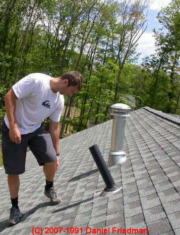

Nope, I used to be a roofer, I know the difference between a pipe jack and a combustion vent. But again my experience is limited to Texas, where pretty much everything is natural gas. I took all of these photos myself. I probably have 30 more examples that I could show you as well.
http://imgur.com/a/l4vgL
These are all from the Houston area. In each of them you can see 2 combustion vents in relatively close proximity, with 2 appliances almost certainly sharing the same attic or closet space.
The first 2 pics are actually of the same house and taken back-to-back, so those 4 vents are within about 10-15 feet of each other. It was a 2 story house and probably had 2 hot water heaters and 2 furnaces. 3rd pic, they're not super close but the appliances are probably within about 10 feet of each other in the attic -- certainly close enough to have the vents mated if they had wanted to. 4th pic, about 5 feet from vent to vent.
