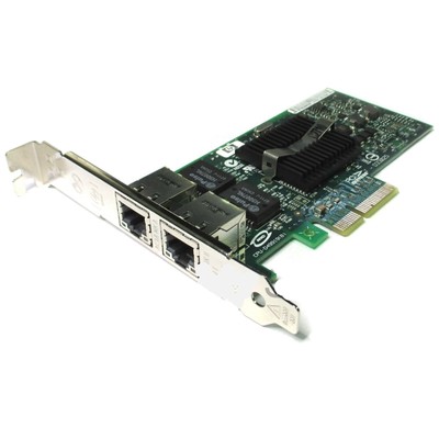

Used HP dual ports NIC like NC360T uses INTEL chip 82571EB.

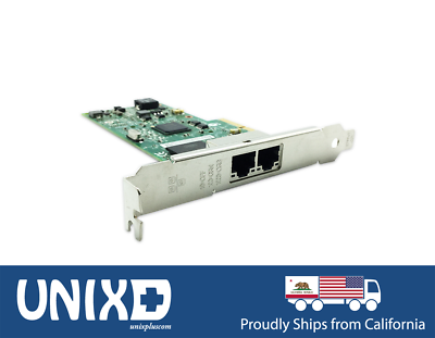

I bought this morning a i350T2G1P20 off ebay, maybe here in a week.
Most recent searches on Intel site it "seems" like only a few cards will work with Win10, i210, i350t2, i350t2v2, and i350am2, long list of others that aren't dual port and/or CAT wiring.
Others very "likely" may work, but I eventually was totally out of a may work mindset. One person suggested all I needed was ONE supported Intel device for the software to recognize and it would then team with any other NIC of any brand. Considered, maybe as just a test, but again the certain to work list of Intel cards was short and none were cheap. Current most desired card looks like the i350T2V2, and China sources on ebay were still like $100.

Thanks, video not in English, but didn't really hinder following what he was doing. I actually considered 2 port version of card he used, but as far as I could tell it was a Intel chip, but not an Intel card, which may or may not work depending on licensing or some such. Shows up in searches for i350am2, but didn't see a listing branded as Intel, so skipped.
Saw that ad on ebay, details too fuzzy. None of the images clear enough to read the numbers and the listed UPC is for a different card. I bought the i350 that has a serial port and ribbon connector on the bracket above the two RJ ports for $27. Looks like a week of waiting for it to arrive and test.
