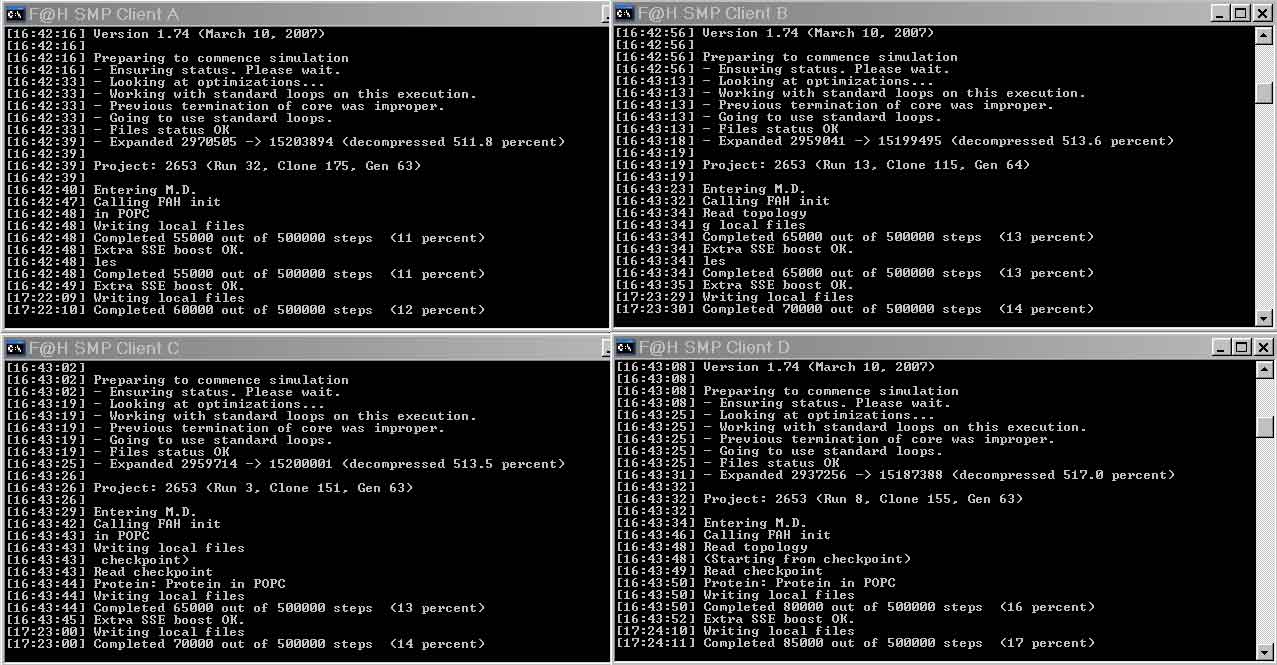

Well, I'm waving the white flag on this. I spent the day reloading a clean installation of x64 and installing 4 separate installations of the SMP client into different directories. I created unique short cuts and assigned machine IDs of 1 to 4.
It looks like they're running fine but every time I shut them down, the WUs become corrupted.
I'm just going to run 2 clients and forget about trying to run 4 clients with Affinity Changer.
Thanks for everyone's help.
