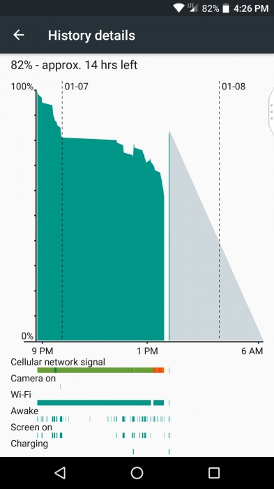

Weirdest thing just happened to me. Was in middle of bush with phone in my pocket so I pulled it out, battery was at around 70% before I left home (did not notice when I pulled it out at that instant but we're talking like maybe a 20 minute interval) and it immediately went into low battery shut down mode except it locked up so I had to manually shut it off. I figured weird, maybe something was eating the battery in the background, like maybe I forgot to close an app or something. I get home and plug it in and boot it back up and the battery is at 83%.
What would cause this to happen? Clearly the battery was not actually dead. Going to let it sit and see if it actually drops suddenly again.
Only thing I can think of is it would be using more battery hunting for a cell signal, but it should not be dropping dead in a matter of minutes. I've been in the bush before where I get a very weak signal so it's harder on the battery but it still lasts the day. Anyone ever see something like this before? It almost feels like some weird software glitch. Or should I worry that it means something is unstable with the battery itself and I should change it?

Yeah it definitly seems like a software glitch more than anything. I just put it through a few tests including freezer and it didn't do it. This is after only 1 minute of charge after the original incident so I'm not even starting off a full charge. It's on the charger now just in case. I will wait and see if it does it again or if this was a weird isolated incident that will get fixed.

Microwave was kept off, to be clear. :p Wanted to simulate a bad signal situation to see if that's what caused it haha.
I let it get down to 20% today and it never did it. Really not sure what this was about but it may have been a one time glitch.
Definitely going to carry a power bank with me if I go in the bush though. Just plugging it in for a short time so it sees voltage gets it going again.
