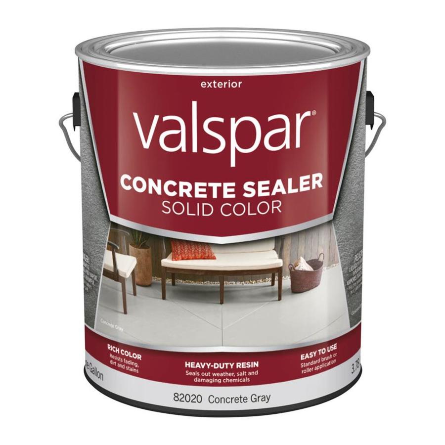

We used this stuff on the basement floor. I used drylock to fill in any cracks (nothing major) in the floor, then we used two coats of the sealer
http://www.lowes.com/pd/Valspar-Sol...te-Gray-Actual-Net-Contents-128-fl-oz/3850763
Not only did it make our basement floor look 100x's better, if there's any water on the floor, it beads up like it was freshly waxed. It mops up easier, and doesn't seem to soak into the concrete at all.
That said.. the stuff is strong. Wear a mask, open your windows, and if you can afford it, sleep in a hotel.
PS: I'd assume it'd work on concrete walls as well.
