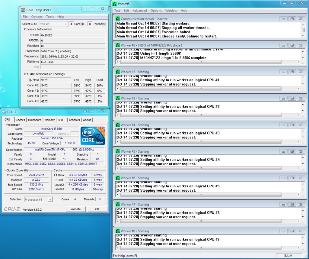

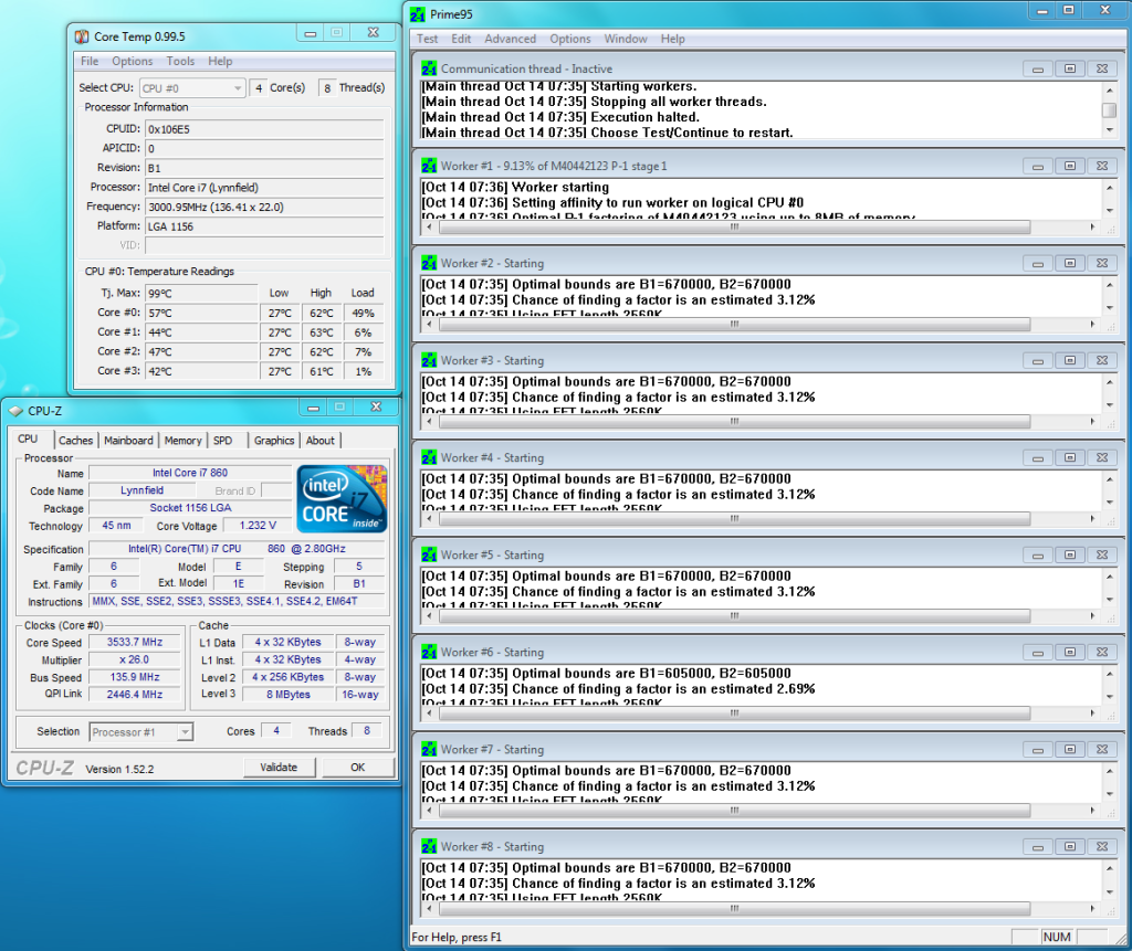

I'll link to 2 screenshots. Note the difference in the XMP OFF screenshot between CoreTemp and CPU-Z at Frequency, Multiplier, and Bus Speed. (If there's a better way to add images please let me know.)
First screen shot, XMP is turned ON, Prime95 is running 1 thread:

Second screen shot, XMP is turned OFF, Prime95 is running 1 thread, discrepancies between CPU-Z and CoreTemp:

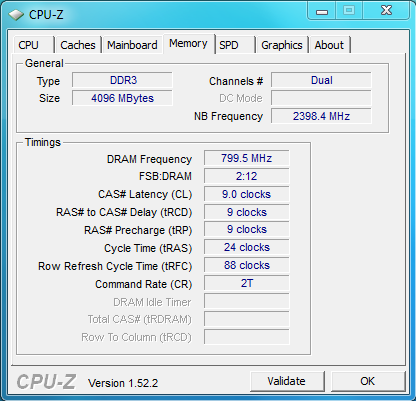

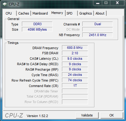

Also, don't know if this is helpful but I took shots of the CPU-Z Memory tab as well.
With XMP turned ON: http://i867.photobucket.com/al...ime95on1CoreandXMP.png
With XMP turned OFF: http://i867.photobucket.com/al...rime95on1Coreand-1.png

I changed a number of the settings from Auto to Enabled. My board now idles with a multiplier of x9, (which if I did the math right is about 1.2GHz, I'm not at it right now so I can't check). And when I run a single thread of Prime95 it hits a multplier of x26 and the max speed of 3.46GHz. Turbo now appears to be working with RAM set to XMP.
Note: this is as reported by CPU-Z. CoreTemp never reports a multiplier and speed higher than x22 and speed of ~2.93GHz. I'm hoping CPU-Z is correct and CoreTemp does not read this processor correctly!
