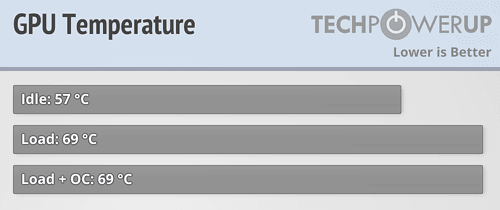

Vapour chambers are essentially flat rectangular heat pipes. They help move the heat from the surface of the die to the heatsink fins more effectively than a similar size and weight of solid copper would. They're really helpful in places like blowers where you're trying to get a bunch of heat into the fin array with a very small height, but there's not a magic ingredient to drop temps. There's a lot more than just a chamber that affects how well a heatsink performs though (surface area of the fins, airflow restriction of the heatsink, etc) and a decent and cheap open air cooler with a couple heatpipes could easily dissipate ~120W with better temps and lower noise than a vapour chamber blower if it's well designed. Look how well the Tri-X Fury cooled, with 72C temps at an almost inaudible 32dB while cooling ~260W according to TPU's testing.

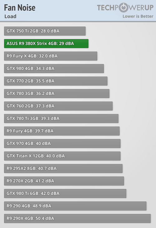

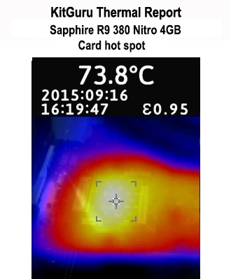

Excellent post. Asus Strix R9 380X (and the Sapphire Nitro 380 I linked above) is a very good indication of how great AIB 480 cards will be.
R9 380X uses about 179W of power, and yet runs at only 29 dBA @ 69C
No blower card from AMD/NV could ever match these noise levels, while also maintaining those temperatures and have 0 dBA idle operation.

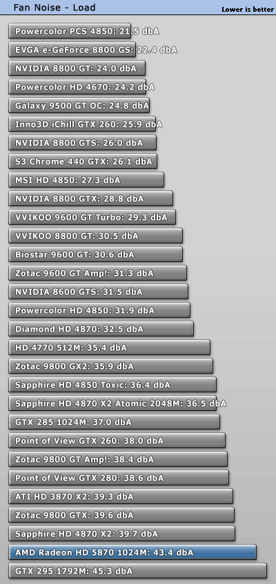

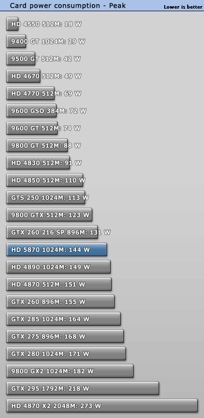

AMD's crap blower from the 5800 series will do great for this card, low TDP, blowers are well within their comfort zone. Low noise, heat exhaust out the case.
Nah. HD5870 blower could barely cope with 150W of power at good noise levels.
Hopefully the blower on the RX 480 is much improved. I'd be perfectly content with 82-84C temperatures as long as it's quiet.

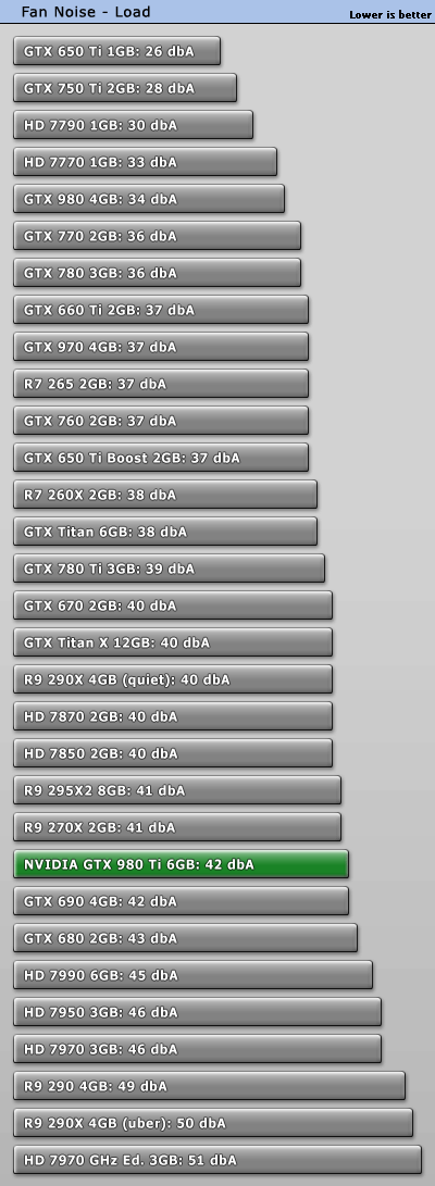

Yeah but the thing is 43 dB is within line for blowers of "quiet" calibre. Compare it to 980Ti blower for example.
I had a few 5800 series cards, I know how quiet they were on auto fan profile.
AMD's blowers didn't get noisy until the 7970 Ghz Ed onwards.

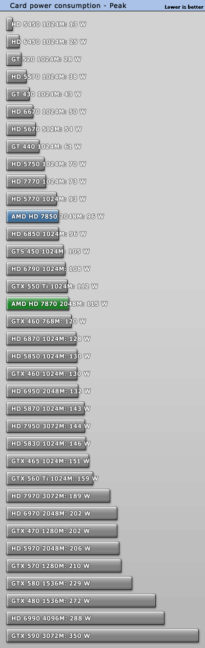

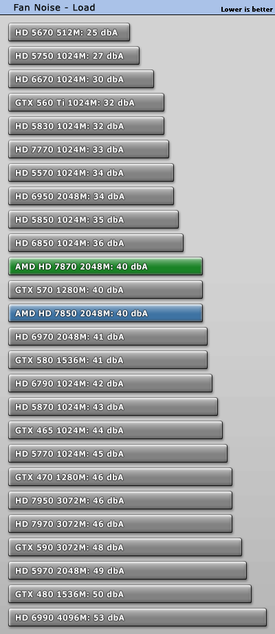

For a more like comparison, check out the small Pitcairn 7850 (RX 480 cut-down) and 7870.
^^ Power usage well below the TDP rating.
Not a noisy blower.
If AMD made any improvements at all, reference cards will be just great.
