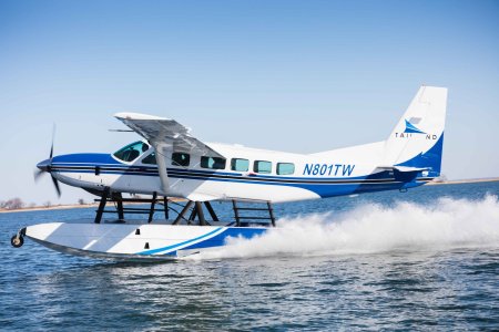

Well, if you could produce a treadmill that could respond fast enough and with enough force to counteract the jet engines then you could make the plane take off with magic because that's what you would need to make such a treadmill in the first place.
Maybe not? :p
So.... the "treadmill" is on pontoons now? :p (and things will not end well in water with the wheels extended)
Also a seaplane can't even begin to fly without most lift coming from the wings. Pontoons are heavy and cause major drag. (this is partially why larger "seaplanes" use the hull for flotation)
