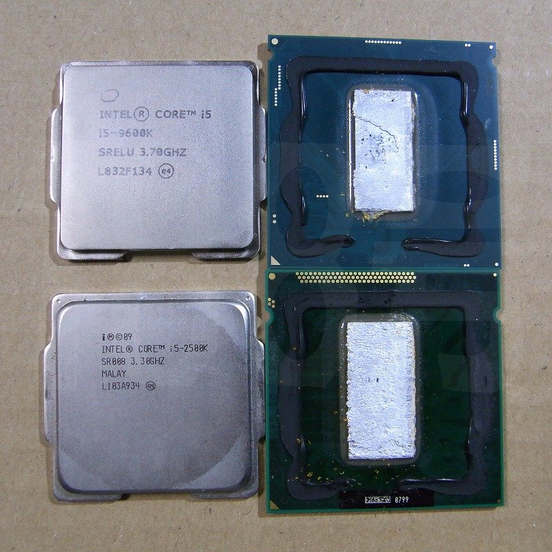

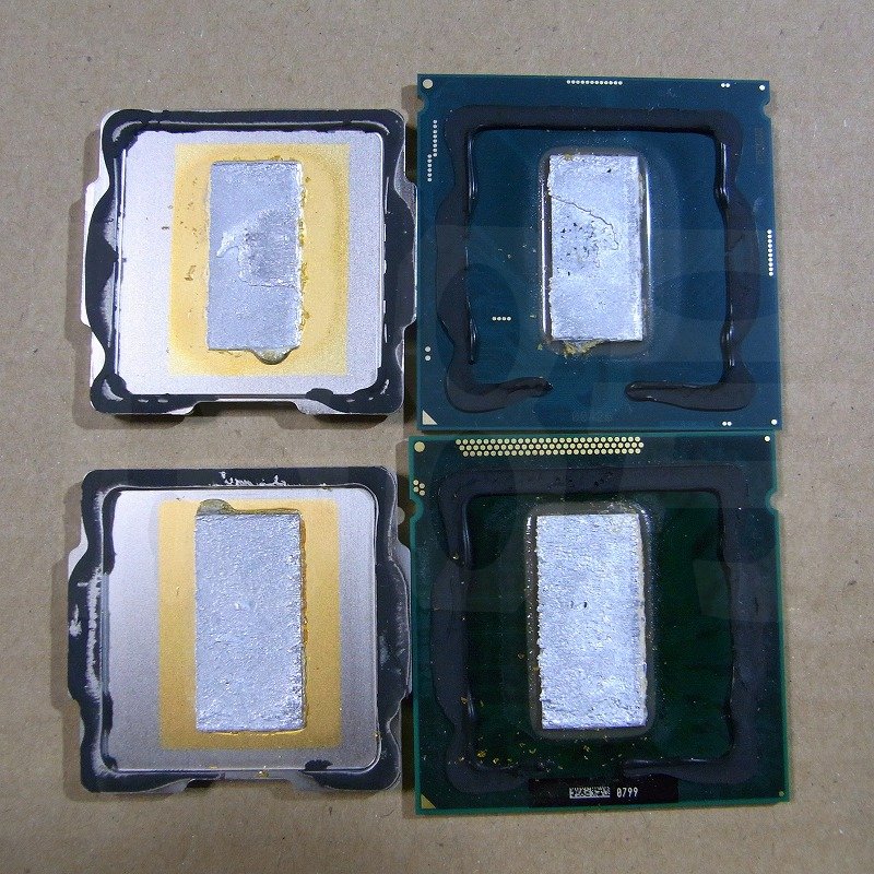

2500K and 9600K delidded:
Not entirely relevant but cool nonetheless
Source
