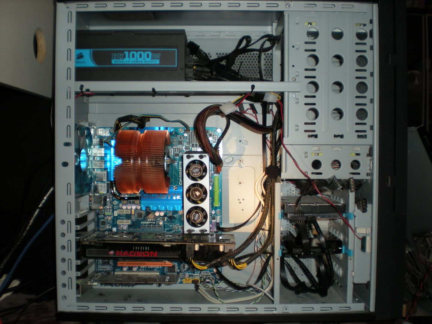

Sort of an odd way of thinking, but I guess you are right... SSD's will get better when the software gets better (OS software that is). Vista wasn't designed for the differences that spindle drives and SSD drives have, and being that HDD still dominate the market we pretty much have to wait to see what they do with Windows 7. I for one have played with all the little tweaks and have found that no tweaks at all work the best(for me anyway). The Titan mostly gives me issues when I use Firefox, and various other internet activities. I turned all the tweaks off and it seems to have calmed down. The one thing that I will say is that I can't bench my drive to what the specs say it should be at... here is a screenshot of a typical test:
http://img.photobucket.com/alb...atisman/screensnew.jpg
and for giggles my pc:
http://img.photobucket.com/alb...thatisman/DSCN0467.jpg
Games load REAL fast still, and all other apps that were slowish on load times pretty much pop right up. I have had this drive since Jan 25th... so I was one of the very first adopters of the Titan. Hope this bit of insight helps!
