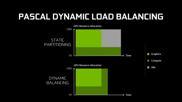

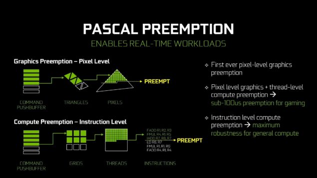

Mahigan said:
Here is what Pascal does...
LL
The first feature nVIDA introduced is improved Dynamic Load Balancing. Basically.. the entire GPU resources can be dynamically assigned based on priority level access. So an Async Compute + Graphics task may be granted a higher priority access to the available GPU resources. Say the Graphics task is done processing... well a new task can almost immediately be assigned to the freed up GPU resources. So you have less wasted GPU idle time than on Maxwell. Using Dynamic load balancing and improved pre-emption you can improve upon the execution and processing of Asynchronous Compute + Graphics tasks when compared to Maxwell. That being said... this is not the same as Asynchronous Shading (AMD Term) or the Microsoft term "Asynchronous Compute + Graphics". Why? Pascal can’t execute both the Compute and Graphics tasks in parallel without having to rely on serial execution and leveraging Pascal’s new pre-emption capabilities. So in essence... this is not the same thing AMD’s GCN does. The GCN architecture has Asynchronous Compute Engines (ACE’s for short) which allow for the execution of multiple kernels concurrently and in parallel without requiring pre-emption.
LL
What is pre-emption? It basically means ending a task which is currently executing in order to execute another task at a higher priority level. Doing so requires a full flush of the currently occupied GPC within the Pascal GPU. This flush occurs very quickly with Pascal (contrary to Maxwell). So a GPC can be emptied quickly and begin processing a higher priority workload (Graphics or Compute task). An adjacent GPC can also do the same and process the task specified by the Game code to be processed in parallel (Graphics or Compute task). So you have TWO GPCs being fully occupied just to execute a single Asynchronous Compute + Graphics request. There are not many GPCs so I think you can guess what happens when the Asynchronous Compute + Graphics workload becomes elevated. A Delay or latency is introduced. We see this when running AotS under the crazy preset on Pascal. Anything above 1080p and you lose performance with Async Compute turned on.
Both of these features together allow for Pascal to process very light Asynchronous Compute + Graphics workloads without having actual Asynchronous Compute + Graphics hardware on hand.

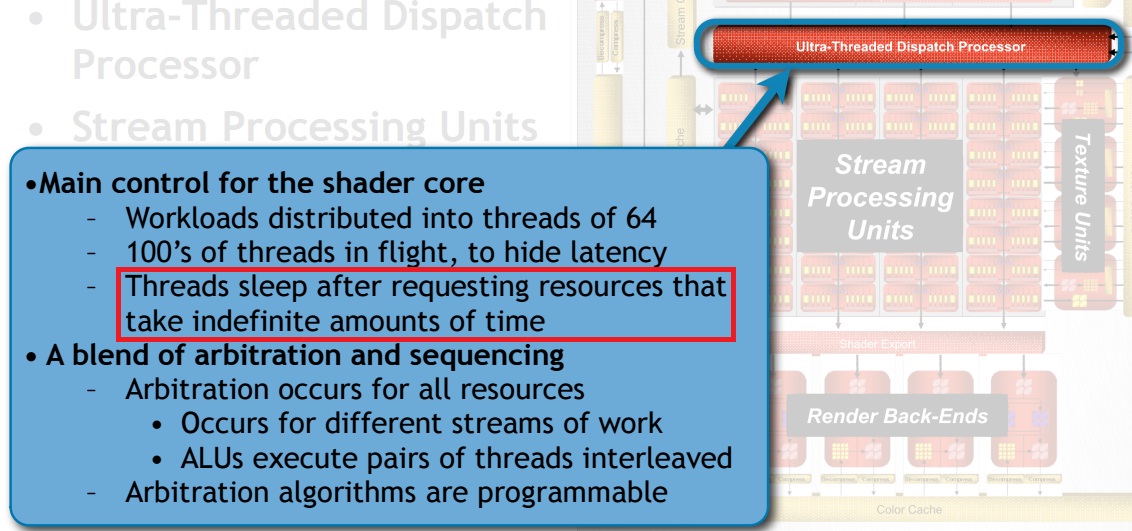

Talking about GCN1 and small performance increase from async.
Mahigan said:
Well once the ACEs execute a compute job... the job is assigned a priority level and is placed into the Ultra Threaded Dispatch Processor. This processor handles assigning tasks to available compute resources (CUs).
LL
If there are no available resources then the tasks pretty much fall asleep. This of course introduces latency. If the GPU is already overloaded without using Async Compute then turning on Async Compute will not help.
Kind of the same reason why Pascal has issues with AotS when using the Crazy preset. There just arent any idling resources for the Dynamic Load Balancing to work its magic.
This is also why Async Compute only offers tiny performance improvements on the XBox One and PS4.
An example that counters this is the FuryX under Doom. That GPU has a TON of idling resources and Doom makes ample use of them resulting in some pretty impressive gains.
Vega will be another GPU which will likely benefit a lot from Vulkan and DX12 due to the more-than-likely healthy amount of compute resources on tap.

Mahigan is almost correct. It's actually better than he said. Due to support of fine-grained preemption, NV has added extra cache and feedback mechanisms to ensure each SMX can halt it's task and switch to a new task, then resume. This ability gives each SMX independence from the main GPC.
In simple terms, Pascal's each SMX can now work on graphics or compute context individually. Whereas on Maxwell it was global (all SMX on graphics OR compute), a limitation which meant it took a performance hit when you try to do graphics + compute.
With their dynamic load balancing, they can schedule compute to idling SMX and graphics to the others. Under light parallel compute usage and lower resolution (where not all the SMX are required for peak rendering performance), this approach can actually result in a performance uplift.
However, when all SMXs are busy (4K demanding game), I expect there to be less performance (or none, if heavy Async is used) gains.
This is still not at GCN's level of granularity, where AMD's SMX (Compute Unit, blocks of shaders) can operate graphics + compute at the same time, ie, true async shaders.
It actually all makes sense now, as we've seen benches with MS's Async Compute example code, under light usage, Pascal gains a few %, but it drops hard as AC usage increases.
In real gameplay terms, 1080 and 1440p, Pascal has some idling SMX which can be put to use via Async Compute, as long as it's not too much compute, there will be a performance gain.

This is not correct. Pascal's dynamic load balancing actually happens within the SMs. In other words, within a given SM, shaders can be re-allocated from compute to graphics or vice versa.
Feb 19, 2009
10,457
10

My understanding is that the lower level nature of Direct3D 12/Vulkan exposes a GPU's asynchronous compute capabilities for programmers to use, thus making D3D12/Vulkan support a prerequisite for asynchronous compute, but technically asynchronous compute is still not an official feature of those APIs.
On the subject of asynchronous compute and Time Spy, for kicks I switched my brother's Radeon 260X into my PC so I could test it (Time Spy refuses to run on his PC for whatever reason). I had seen results from that Overclock3D thread with a 7870 showing no gain from asynchronous compute, and Mahigan explained that's probably because at that level and below all of the GPU's compute power is probably being used already. When a GPU can't provide the resources for async compute, it can even cause internal lag and slow down rendering, as seen with Maxwell chips trying to use a-compute at crazy detail levels in AOTS vs running with a-compute turned off. My tests showed that to pretty much be the case with a 260X -- there was no benefit from turning a-compute on, and in fact the scores with a-compute on were slightly lower than the scores with it off.
Point is, asynchronous compute, at least its implementation in Time Spy, does not help low-end AMD GPUs like the 260X.
